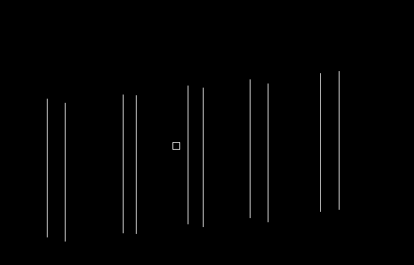

hi guyes
i wish anybody can help me
i'm searching for lisp make spline at the end point of lines that i selected .
Link to post
ReMark
I don't understand the question. Make a spline at the end point of a line? Do you mean create a spline between the endpoints of two or more lines?
Link to post
drafting_man
firest thank's mr remark for your reply
what i mean i have many lines and i want to create spline from the end point of each line like this image

Fun quickie, now back to watching He-Man with my little girl...
(defun c:SPLC (/ ss lst)
 ;; Spline Connect
 ;; Alan J. Thompson, 05.15.10
 (vl-load-com)
 (if (setq ss (ssget '((0 . "LINE"))))
     (vl-cmdf "_.spline")
     (foreach p (vl-sort
                  ((lambda (i)
                     (while (setq e (ssname ss (setq i (1+ i))))
                       (setq lst
                              (cons
                                (car
                                  (vl-sort (list (vlax-curve-getStartPoint e) (vlax-curve-getEndPoint e))
                                           (function (lambda (a b) (> (cadr a) (cadr b))))
                                lst
                    -1
                  (function (lambda (a b) (< (car a) (car b))))
       (vl-cmdf "_non" [color=Red](trans p 0 1)[/color])
     (vl-cmdf "" "" "")

wow alanjt u did it that what i want
than;'s man u are genius
:) You're welcome and enjoy.
