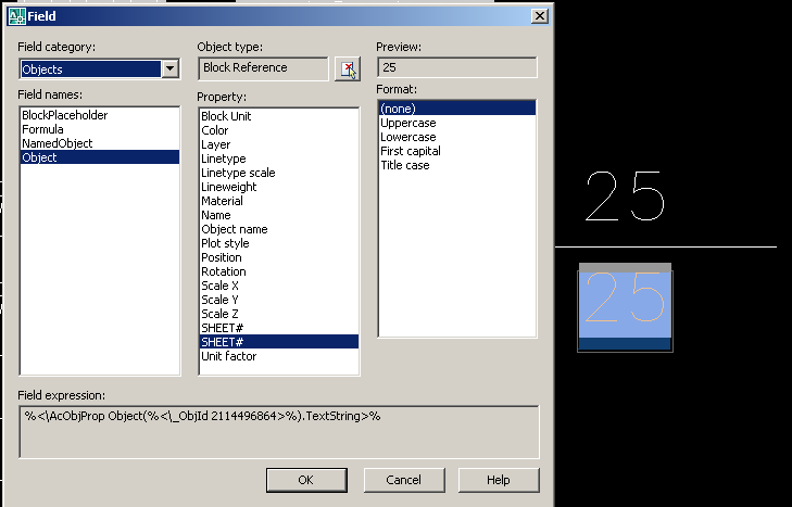

DNK
I think I ran across a way of using fields to do it.
Edit:
Make it a block.
In one attribute, insert a field.
Field Category-->Objects
Fileld Names-->Object
Object Type-->Select the block
Property-->[The other attribute tag]
Regen will update the fielded value.

Ryder76
Way cool DNK - I'll take a look into that. I could use that ability for wire naming! Thanks.:)

DNK
Edit:
Make it a block.
This can also be done with raw text.
If you have two text elements, edit the text of one, insert field.
Field category --> Object
Object Type --> [select the other text element]
Property --> Contents

alanjt
block.PNG...........
