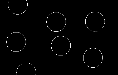

Demesne Posted July 2, 2010 Share Posted July 2, 2010 Alan, Is there any way that instaead of connecting with lines, the code in post #31 could work to connect objects with 3D polylines? This is a great routine as it is. It's already saved me alot of time - thanks to you all! Demesne Quote Link to comment Share on other sites More sharing options...

Demesne Posted July 9, 2010 Share Posted July 9, 2010 Well, only in as much as I looked at the code and then realised there wasn't a simple line to change from say 'line' to '3dpolyline'. I sometimes manage to tweak lisp to do what I want it to but those changes are very basic. My programming capabilities are limited to Casio calculators! I wish I had more time to sit down and learn how to actually write my own code. I see from your animation that you have connected with a polyline, can this be done with a 3D polyline? Quote Link to comment Share on other sites More sharing options...
Lee Mac Posted July 9, 2010 Share Posted July 9, 2010 Give this a go: (defun c:BlkCon ( / ent l gr code data ss ) (vl-load-com) ;; © Lee Mac 2010 (if (setq ent (LM:SelectifFoo (lambda ( x ) (eq "INSERT" (cdr (assoc 0 (entget x)))) ) "\nSelect Block: " ) ) (progn (setq l (list (cdr (assoc 10 (entget ent))))) (while (progn (setq gr (grread 't 13 2) code (car gr) data (cadr gr)) (redraw) (cond ( (and (= 5 code) (listp data)) (mapcar '(lambda ( from to ) (grdraw (trans from 0 1) (trans to 0 1) 4 1) ) (cons (trans data 1 0) (reverse (cdr (reverse l)))) l ) t ) ( (and (= 3 code) (listp data)) (if (setq ss (ssget data '((0 . "INSERT")))) (setq l (cons (cdr (assoc 10 (entget (ssname ss 0)))) l)) ) ) ( (member code '(13 32 25)) nil ) ( t ) ) ) ) (entmakex (list (cons 0 "POLYLINE") (cons 10 '(0 0 0)) ) ) (mapcar '(lambda ( p ) (entmakex (list (cons 0 "VERTEX") (cons 10 p)) ) ) l ) (entmakex (list (cons 0 "SEQEND"))) ) ) (princ) ) (defun LM:SelectifFoo ( foo str / sel ent ) ;; © Lee Mac ~ 12.06.10 (while (progn (setq sel (entsel str)) (cond ( (vl-consp sel) (if (not (foo (setq ent (car sel)))) (princ "\n** Invalid Object Selected **") ) ) ) ) ) ent ) Quote Link to comment Share on other sites More sharing options...
