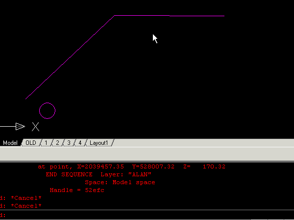

chulse Posted May 24, 2010 Posted May 24, 2010 Can you gurus give me a nudge in the right direction please? What I'd like to do is insert blocks and points along a selected Pline given a list of data containing distance along the line and depth below it. Could the depth value be translated to a Z value based on the elevation of the pline? I'm not asking for a completed program, just some pointers to get started. Thanks! Quote
lpseifert Posted May 24, 2010 Posted May 24, 2010 Look into the vlax-curve-getPointAtDist function. This will return the coordinates (x y z) of a point at a specified distance along a curve (line, pline, spline, arc...). You can then manipulate the coordinate list to suit your needs. Quote
alanjt Posted May 24, 2010 Posted May 24, 2010 http://www.cadtutor.net/forum/showthread.php?t=46309&highlight=copyalongcurve Civil 3D has several options to create points along curves. Quote

alanjt Posted May 24, 2010 Posted May 24, 2010 Trust the CAC. If the distances are different, you would use Dynamic mode. Quote
