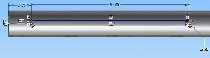

linnmaster Posted May 26, 2010 Posted May 26, 2010 Attached for your reference in 2009 version. My dimensions are just there to indicate what you should have ... I'm using metric rather than imperial. But that's the simplest way to construct what you're after. Of course, it depends on design intent, but that's a start. Hope that helps. JD'S tutorial is very very very good. I learned a lot from it myself. Best, David main_shaft_DL.zip Quote

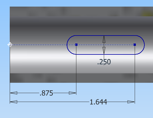

JD Mather Posted May 28, 2010 Posted May 28, 2010 Create a construction line from the projected origin to center the holes. If you are doing a slot you might as well sketch a slot and then Extrude-Cut. Make sure your sketches change color indicating fully constrained. Quote

Srhenson Posted May 29, 2010 Author Posted May 29, 2010 JD, am I getting closer? I had some struggling with your last couple of post, and the doc you sent was hard for me to understand. Most I felt like it was greek to me.........But I feel like I am progressing. Thanks for you patience. Main_Shaft_rev3.zip Quote
JD Mather Posted May 29, 2010 Posted May 29, 2010 Sign up for a class. You are missing construction line from image I posted and missing tangent constraints between the lines and the circles. The lines should have vertical constraints. You have two .25 dimensions when only one is needed. Your sketch 2 has not changed color. These topics are normally covered in the first 15 minutes of class. Go back through that paper and Stop and any step you do not understand and ask for clarification here. Quote
