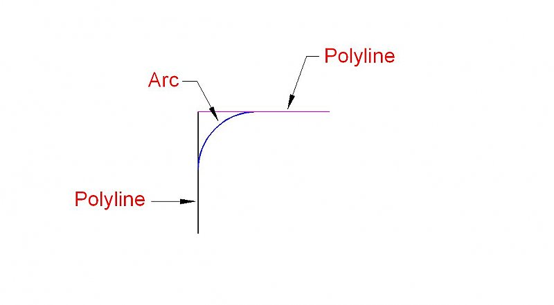

jukkoo Posted May 26, 2010 Posted May 26, 2010 Hi, Every time I fillet 2 separate polylines (regardless of the radius), Autocad automatically joins them into one polyline. Is there an option to switch this automatism off? So that the result is similar to lines fillet, so that I have 3 separate polylines, the two I started with and the arc as the third one. I could just be using lines instead of polylines, you say, but unfortunately that is just not an option, they need to be plines. Working on Autocad 2007 Full Thanks Quote
ReMark Posted May 26, 2010 Posted May 26, 2010 it can't be done. move on. stop bitc*in around and start drawing with your hands. how do you like that polyline? n00b Bad day at the office? I don't think any of that was called for. Quote
arhic Posted May 26, 2010 Posted May 26, 2010 you can try NO TRIM option while using fillet. it will create arc between two polylines but it will not trim them or join them. downside side of this method is that you will have to trim the rest by hand. Quote

ReMark Posted May 26, 2010 Posted May 26, 2010 jukkoo wrote: "...so that I have 3 separate polylines, the two I started with and the arc as the third one." This implies you have two lines with an arc between them. If that is the case then the advice given above by arhic does work. I tested it myself. Obviously it won't work if the fillet radius is set to "0" though. You must specify a radius greater than "0". Quote

ReMark Posted May 26, 2010 Posted May 26, 2010 I understand you have two separate polylines. Where is the arc located in relation to these two polylines? I'm imagining a polyline connected to one end of an arc followed by a second polyline connected to the other end of the arc. What are you doing? Quote
ReMark Posted May 26, 2010 Posted May 26, 2010 This is what I am referring to. For the sake of clarity one polyline is black while the other is magenta. The arc between them is blue. The polylines have not been trimmed yet but after they are I will still have three separate entities. Quote
jukkoo Posted May 26, 2010 Author Posted May 26, 2010 ok, I'm gomma try to explain - I need polylines instead of lines because the lines do not have global width option - I want them to be separate because I only want to be able to offset only one of them - I know I can use break at point command to get this result, but I was just wondering if there was a way to speed things up with just one command (or option in the fillet command) Quote
ReMark Posted May 26, 2010 Posted May 26, 2010 I guess I just have mush for brains this morning. My example above has polylines. Even the arc is a polyline. My example keeps everything separate. My example allows me to offset both polylines and the arc if I wanted to. My example did not require the use of the Break command. There is no way to speed things up with one command unless you use a custom lisp routine or, in newer versions of AutoCAD, the Action Recorder (for creating a macro). Quote
