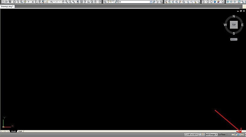

dumfatnhappy Posted May 26, 2010 Posted May 26, 2010 have you considered using the "isolate objects" tool? it lets you "hide" (or freeze if you will) by entity. it's the little yellow light bulb in your lower right command line bar. Very handy tool! Quote
