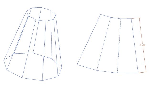

bkravishankar Posted May 29, 2010 Share Posted May 29, 2010 Hi all, M new to CADtutor. Pls help me in solving my problem mentioned below: I want to genarate plan view and elevation of ducts(Staright, cone, transition piece or elbows). for example: my inputs for a straight Duct will be Dia, Length and start point. is it possible to get a LIsp code for this so that i can work up on for other elements. In all my problems i will be haveing extraction points and filter positions. so i will use different ducts to conect between these systems. now i am showing all views manually which is tedeous n time consuming. i am looking for a way to make this automate so that i can use my time for other issues. Kindly suggest me the possible solutions. i am ready to show a small project layout if some one wants. to mod: sorry if posted in unrelavent area, pls change if needed thanks a lot guys, Quote Link to comment Share on other sites More sharing options...
Tankman Posted May 29, 2010 Share Posted May 29, 2010 You can download a free trial for duct work here http://www.mtc-software.com/products/design2fab.php Does a quick, excellent job. Produces *.dxf files. Cone-3_Piece.dwg Quote Link to comment Share on other sites More sharing options...
