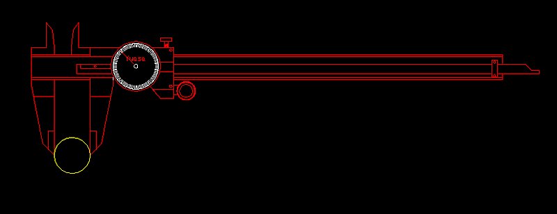

kencaz Posted June 6, 2010 Share Posted June 6, 2010 I knew these would come in handy someday... Quote Link to comment Share on other sites More sharing options...
Tankman Posted June 6, 2010 Share Posted June 6, 2010 I knew these would come in handy someday... Perfect! Starrett? Brown & Sharpe? Gave me a good chuckle and, I'll bet quite a few more. Quote Link to comment Share on other sites More sharing options...

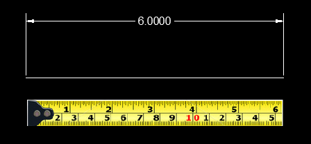

CALCAD Posted June 6, 2010 Share Posted June 6, 2010 Raithneach, To answer your question, yes, there is at least one way to do this. You need to measure the height of your drawing window with a scale or tape measure. Then, in the command line type Zoom, C (center), pick the approximate center of the object you want to display, then enter the measured height. This should display something close to 1:1 scale. You may want to adjust the height value to better approximate the object size. That number is the calibration factor for your monitor. This only applies to 2D entities. It might be interesting to work out a method to correctly display 3D entities at the display plane in various orientations. Maybe someone has already done this. Quote Link to comment Share on other sites More sharing options...
kencaz Posted June 6, 2010 Share Posted June 6, 2010 Raithneach, To answer your question, yes, there is at least one way to do this. You need to measure the height of your drawing window with a scale or tape measure. Then, in the command line type Zoom, C (center), pick the approximate center of the object you want to display, then enter the measured height. This should display something close to 1:1 scale. You may want to adjust the height value to better approximate the object size. That number is the calibration factor for your monitor. This only applies to 2D entities. It might be interesting to work out a method to correctly display 3D entities at the display plane in various orientations. Maybe someone has already done this. I don't think it needs to be that complicated: KC Quote Link to comment Share on other sites More sharing options...
