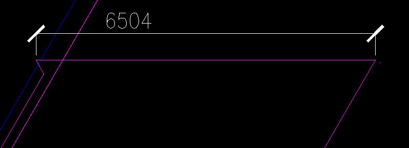

Hi guys, i faced a problem in drawing a dimension line parallel to the isometric view.
Attached is the print screen of the weird dimension. the dimension lines which showing 6504 value suppose to be parallel to the lines(magenta colour). Aligned and Linear dimension has been tested but produced same result.
Appreciate if any expert can advise me on this matter.Thanks
Dimension > Oblique
Thanks bro. U save me lot time:D
