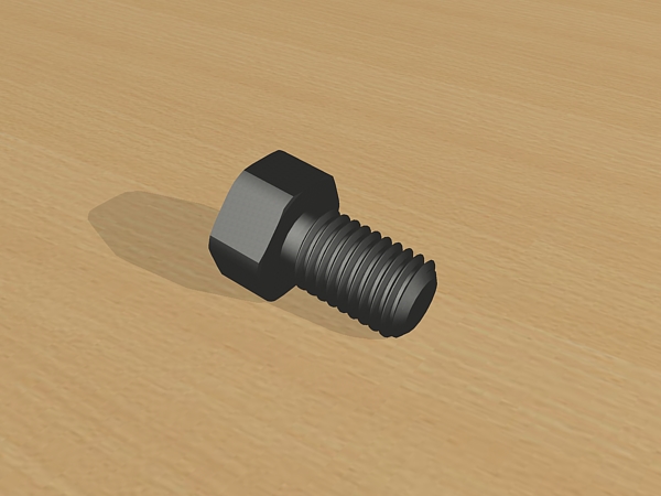

I found a way to make screw threads with no lisp routines involved. I use 2000. I'll post a tutorial (if anyone's interested...) when I get home from work today. Here's an image of a Pem Stud I modeled using this method... (the dimple on the bottom was on purpose)

alot depends on how realistic you need your bolt, if you want a reprenstation of a thread then a revolved solid will give you the look, but if you require a true spiral thread then lisp may be the only way to go. i have use a simple triangle revolved around the shaft of the bolt then subtracted to make a pretty convincing but non realistic thread view
You're gonna have to just ignore that picture of the bolt right there. It's something I made a while back and realized that it's incorrect. If you look at it from any other view you'll see that the spiral looks a little funky. I've tried and I absolutely can NOT make a solid spiral without using any sort of lisp. I can make it out of surfaces, but that does not good.
if you do not need an accurate thread then look for my explianation on how i made a NUT using Donuts, it gives an accurate looking spiral thread but the thread shape is wrong, instead of the threads being triangular in shape they are circular but when used it is quite hard to tell the differance and so looks ok aslong as all you require is a representation of a thread and your not needing the accurate thread shape.

I think the way I use to make bolts/threads is not the fastest way to do it, but it is a way that doesn't use Lisp.
With the "helix" command I set out the main caracteristics of the thread such as distance between the turns and the amount of turns, then I draw the "tooth" of the thread according to my manual with a polyline. (So it is a very accurate thread) This I place on the end of the helix.
Last thing to do is to "Sweep" this polyline using the helix as a path.
Results are good enough for my use.
