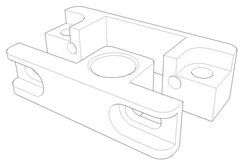

bbankston Posted July 1, 2010 Posted July 1, 2010 Is there anyway to look at this ISO in 2D? I've tried the "view" command but that just skews the drawing. Any help is greatly appreciated. 2pi-3559.dwg Quote
ReMark Posted July 1, 2010 Posted July 1, 2010 It views just fine for me. What did you expect to do, view it from another isometric viewing angle? Quote
bbankston Posted July 1, 2010 Author Posted July 1, 2010 As far as what, ReMark? I mean, I can look at it too, I just can't see front or side elevations of the drawing. I did a search on the forums and when I tried the "view" command it didn't work. Thanks for the quick reply. Quote
bbankston Posted July 1, 2010 Author Posted July 1, 2010 ReMark, If you can view the front & side elevations could you save it and send back to me? I'm guessing you've got the full version of CAD. Quote
dbroada Posted July 1, 2010 Posted July 1, 2010 I think it is just an isometric drawing the same as used to be done on a drawing board. It is not a 3D drawing that can be looked around. Quote
bbankston Posted July 1, 2010 Author Posted July 1, 2010 Ah. Well, that stinks. I suppose I'll try and draw it 2D using the ISO. Thanks for the help anyway, fellas! Quote
Dana W Posted July 1, 2010 Posted July 1, 2010 Short answer, Nope. it was drawn in World UCS view for some reason, rather than one of the 2D isometric views. I don't understand why it was drawn like that, nor whether it is right or wrong. It does make it difficult to draw a 3 view (front, top, 1 side) to go with it, or add dimensions. Maybe someone else will come along and explain it to us. I'd like to know the purpose behind using this particular viewpoint myself. Isometric is NOT 3D. It is a 2D drawing. You will notice that none of the lines are foreshortened as if it were a 3D perspective. There are no 'artistic' vanishing points. It could also be dimensioned at any line with accurate dimensions as if it were flat. Isometric View came about way way back in the day of the quill pen, and parchment, when it was used to show a simulated 3D view on a 2D drawing surface, and at the same time keep each line to scale. Quote

Dana W Posted July 1, 2010 Posted July 1, 2010 Dana W, I disagree. Isometric is 3D by definition. You have 3 dimensions, width, depth and height. Sure it doesn't go to a vanishing point but it does have 3D. With respect, Brandon Bankston Well, sorta anyway. You are able to illustrate the 3 dimensions, but it is still 2D. Also with much respect. Dana Quote
Dana W Posted July 1, 2010 Posted July 1, 2010 You're good, Dana W. Hopefully someone will explain the process behind this. I'm currently working on the 2D now. I'll let ya'll know how it goes. Okey, dokey. I haven't been drawing electrically for that many years, and I need to learn much myself. When I do an ISO, I use one of the 2D ISO views too, not the World UCS view. Quote

bbankston Posted July 1, 2010 Author Posted July 1, 2010 I think I've got it. How's it look? 2pi-3559.dwg Quote
Dana W Posted July 1, 2010 Posted July 1, 2010 Dana W, Since I'm running AutoCAD LT over here I've had to go with 3rd party software for my ISOs and Perspective 3D renderings. Google SketchUp, it's freakin' amazing! Yeah, me too. Almost 5 grand for software? Are you kidding. Howzza dude gonna make a living? I am not working to make somebody else rich anymore. It's just me, so I have to wait for 3D AutoCAD until my rich uncle (if I have one) passes on. HEY, what view didja move that thing to? It looks good. I tried all of them and didn't find the right one. Quote
ReMark Posted July 1, 2010 Posted July 1, 2010 There are three types of pictorial drawings. They are Perspective, Isometric and Oblique. Source: Basic Technical Drawing by Henry Cecil Spencer. Quote
bbankston Posted July 1, 2010 Author Posted July 1, 2010 Dana W, I created the 2D using the information provided from the Iso. I got the diameter for the holes and center line dimensions using the perpendicular lines from the drawing. That's what the red Xs are for. Quote
Dana W Posted July 1, 2010 Posted July 1, 2010 Dana W, I created the 2D using the information provided from the Iso. I got the diameter for the holes and center line dimensions using the perpendicular lines from the drawing. That's what the red Xs are for. OK, so it is not the same drawing. I thought I was missing a view selection or something. thx. Quote
bbankston Posted July 1, 2010 Author Posted July 1, 2010 There we go. It's like I'm reverse engineering this thing. I'll get to the 3D Model next. 2pi-3559.dwg Quote
