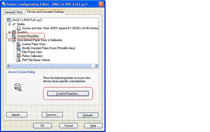

You can edit the custom properties to exclude layer info. I also set mine to convert fonts to graphics (solves the missing font popup error I was getting occasionally).
Save it as a new .PC3 file...
How do I set it to convert fonts to graphics?
Cheers
Change the custom properties:
you can change the resolution to help reduce file sizes also. I think 300 dpi is more than enough.
Maybe you don't have the same options in an older version...?
I attached the one I use (remove the .txt extension).
Copy of DWG To PDF-FLAT.pc3.txt

For the text to be "seen as text" (and not as one big image) by Adobe , uncheck the "as geometry" box under Font Handling.
The file should be able to be manipulated by Acrobat either way (markups, etc)...
