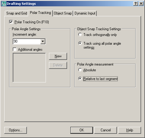

Could you please explain a little bit more.
I got your idea but I don't know how to do the "relative to last object" part.
Use polar 'relative to last object'.

Last segment is last segment snapped to. Do a nearest/end, etc. snap from any line/pline, etc. and see.
