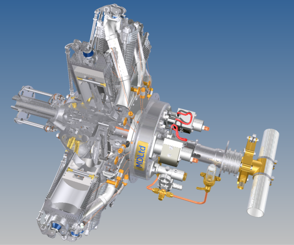

I have attached herewith a rendered image of a Bentley BR2 engine that I created sometime back. I wanted an image with a sectional cut through selected parts and then to colour the cut surfaces so they contrasted and stood out.
I made a cut in the assembly and partly achieved what I wanted but could not apply coloured properties to the sectioned surfaces.
Does anyone know of a way I can achieve this using Inventor 2011?

Hi Guys,
Thanks for replying to my post.
I am working within the assembly environment and ideally want to stick to that so I can produce a photo-realistic image. An inventor drawing does not produce the quality of image I require. I also need to have full control over lighting, shadows, backgrounds, etc.
Surely .ipn files are for exploded detail drawings and animations?
Your comment about sectional views within assemblies is knew to me, I don't know of any way to do that other than the way I did in the image above. I can see no icons that allow me to do what you describe? How do you go about it?

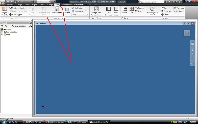

Hopinc, i dont have 2011, and currently at work i only have a version from 2007 so the interface is different. The section button should be on one of the ribbon tabs. When i have a chance later I will take a look at 2010 which should be very similar in layout. In the mean time go to your help file and search for quarter section and see what comes up.

I took a look at 2010 and the section view is on the View panel of the ribbon. Here is a screen shot to show you.
Hi Matt,
Thanks for going to that amount of trouble for me. Unfortunately it was a little bit wasted (but still appreciated) as I had already found and tested your method from your previous post. Cheers my friend!
Your technique is quick but it has two major drawbacks that preclude it's use for my purpose - 1) The assembly does not appear as cross-sectioned when rendered in Inventor Studio. 2) You cannot colour the cut edges.
The cross-section does not come through into an Inventor drawing, so apart from being used as a visual confirmation device I cannot see a use for it at all. Obviously, as far as drawings go, Autodesk intend the end user to create sections such as these by using the sketch and break out commands only.

Mark, using a cutting block is quite an interesting solution. However, as most of the parts are made of the same material (steel) it is doubtful that the cut edges of the cross-section would show up any better than in the assembly cut I made for the attached rendered image.
Unfortunately, sectioning the individual parts is a bit of non-starter as orientation would be a major problem. There would have to be a lot of toing and froing to match the sections together. I also feel that it would take too much time to achieve and end result.
In all honesty I am not too unhappy with the results I achieved on the real photo-realistic which appears on my web site (not the whittled down version shown in my post), but I would still like the "icing on the cake" -coloured section surfaces.

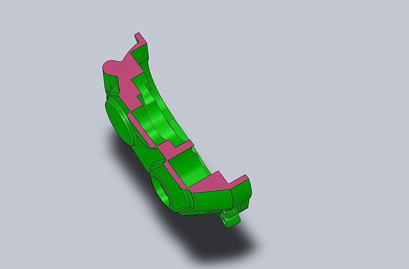

well I dont know that ive seen a need for a photo realistic render with some sort of hatched section face before. That's typically reserved for black/white images. Having the color sections kinds of defeats the purpose of a photo realistic render. But in reality whenever you see engine cut away parts from factories they color the cut edges to make the cuts more evident :) another BUT, if you were to actually cut the parts in the assembly rather than trying to section them, coloring the faces would work, but it is a good bit more work. In solidworks ive found a way around it with imported parts. When you apply a section to the part, you have the option to color the face. This appears in the renders as well. But this is a result of the nature of imported parts and would still be a ton of work on something like your model. Im interested to see what JD comes back with.
