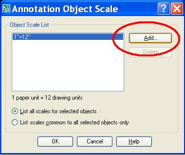

Assign/add a scale to the text (the same as the viewport's scale). This can be done in Properties or select the text and rt-clk

Erm, ok. I set the Object scale of one of the pieces of text but in the properties as you've shown above, so I set it to 1:100 as it would be in the layout, but it keeps going back to 1:1?
