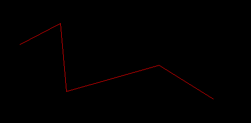

Hello all,
Does anyone knows a way to perform a stretch command but instead of stretching in rectangular dimension, rotate them around a center point with a number of degrees.
If there is a way to rewrite Stretch command in AutoLISP, it will be fairly easy to change it to polar version of it.
This is who it would work:
Thanks.
  1. Select the object to display Grips.
  2. Shift-Select grips you want to move.
  3. Select grip for basepoint.
  4. Alter object...
eg.
