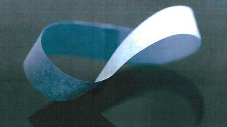

Hello everyone!
I've just joined the CADTutor community and I must thank everyone for their efforts in passing on AutoCAD knowledge. Excellent website!
In particular, I want to thank Fuccaro for his Mobius Surface routine which has proven extremely useful.
However, I don't know a thing about the AutoLisp language; and I want to modify this routine to generate a Mobius Strip with an elliptical section instead of a circular one.
I need to create strips with both major and minor axis perpendicular to the folding point and be able to modify this dimensions. Any thoughts on how can this be accomplished?
Thanks in advance! :)
Hello Stupens!
I thought that the Mobius strip is a theoretical thing -I am surprised to see this big interest. Well, I wrote the programs for fun and I provided no options for changing the shape, the radius and the other parameters. Changes must be operated in the program.
I will look what I can do but not these days. Sorry!
OK, here it is!
The cross section is eliptycal.
But let's call it "Twisted thorus" or so because it is not a Mobius strip any more.
It is more complex as the previous one. As solid it would take forever to be generated, so I created it as a surface. It looks smoother too.

Hello Fuccaro!
First of all I must say I look at your talent in awe and wonder...
How have you acquired all of this knowledge?
I thank you very much for your time and effort, but I must admit I didn't explain myself accurately:
...and I want to modify this routine to generate a Mobius Strip with an elliptical section instead of a circular one...
I used the term "section" meaning the plan of the strip instead of the cross section. Sorry, my mistake. :oops:
The kind of surfaces I need to model have an elliptical plan such as these:
You might wonder why all the interest in Mobius Bands?
I'm an architecture student currently analizing the Max Reinhardt Haus project by Peter Eisenman. This project designed in 1992, unbuilt; is based upon the development of surfaces based on a Mobius Strip.
And this is the corresponding geometry at the core, in plan and elevation...
Notice how the "interior ellipse" is off-centered from the "exterior" one?
If I can configure the strip, i'll be able to recreate the volume that defines the surface of the building. (if I can rotate the planes according to the constant turn of the band, that is...)
Anyway, this work is due next tuesday and I'm running short. I'm going to focus on finishing the rest of the analysis first and i'll leave the 3d model as a bonus if there's some extra time left.
Once again, thank you for your time and patience.
I'm sure the Twisted Torus will become famous...
Keep up the good work! 8)

Hi,
Does anyone know of a way to export all the points of a mobius mesh or mobius solid to a text file?
Thanks
Moesian
Two ways coming up in my mind:
1. Modify the existing routine to write the points in a file as it calculates them
2. To write a lisp to export the points from a mesh. To export the solid points is more complicated.

I need help drawing a mobius strip about 12" long by 1" wide, I see that there a lot of talent here please help. mobius.jpg
Welcome in the forum, Gilbert!
I wrote the Mobius lisp in the dark era of pre2007 AutoCAD. These days people may use Loft and Sweep, this brought major changes in modelling, including the possibility to draw a Mobius strip just from AutoCAD.
But if you wish to play: see the routine I posted years ago, on the first page of this thread. Also CADTutor published instructions about how to use Lisp routines. In the routine itself are some instructions about changing the dimensions of the Mobius strip. So... draw one and scale it until it fits your needs. Good luck, post again if you have problems.
