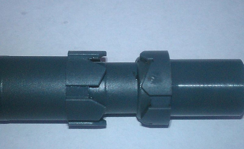

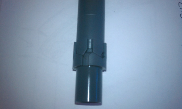

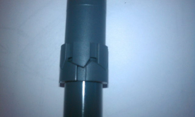

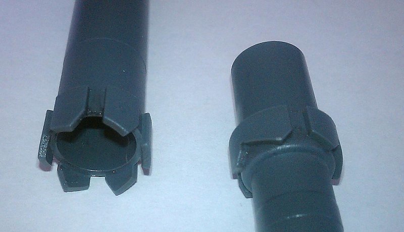

TheJanekGroup Posted July 9, 2010 Share Posted July 9, 2010 I have a 2 part gear unit that works like the click action of a ball point pen. It has a series of teeth around it that slide and lock on each other. I have great measurement tools, Im working on Inventor 2010 (also have 2008), but I cannot find out how to ge the teeth to extrude from the center axis on a coil like they do. The parts mirror around the unit, so all I need to do is draft one of each tooth to make this work. I really need this done TODAY. If anyone can assist me by email or phone, please let me know. I would be more then happy to pay you by paypal for you time. I can send pictures, video, and measurements of the parts, or you could walk me through it by phone, skype, etc. Please email me at jonas@thejanekgroup.com or at 618-709-9263 Quote Link to comment Share on other sites More sharing options...
JD Mather Posted July 9, 2010 Share Posted July 9, 2010 Im working on Inventor 2010 .... Looks like trivially simple parts - attach zip and attach what you have so far. Quote Link to comment Share on other sites More sharing options...
TheJanekGroup Posted July 9, 2010 Author Share Posted July 9, 2010 What format should I send it in? I have inverntor 10? Have tooth measurements based on OD square dimensions, Ill sketch and upload them too. Quote Link to comment Share on other sites More sharing options...

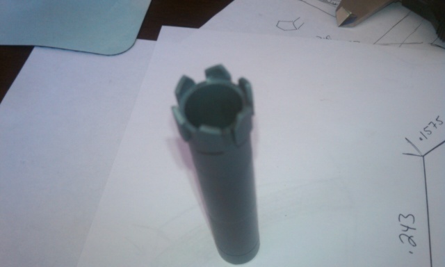

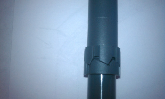

TheJanekGroup Posted July 9, 2010 Author Share Posted July 9, 2010 Attached is a .zip of two Autocad 2010 .ipt files of the two parts, and severl more pictures. One part has 6 teeth, equally mirrored around the center axis. The other piece has three double teeth, also equally spaced around the center axis. All of the teeth are cut on angles back toward the center axis, and but there is some "twist" for lack of knowing the proper term, that is on the top face of the teeth that slopes inward and downward. Button Part.zip Spring Part.zip Quote Link to comment Share on other sites More sharing options...

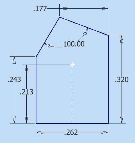

TheJanekGroup Posted July 9, 2010 Author Share Posted July 9, 2010 This is what I am measuering on the tooth for the button part using calipers. This is on the outside edge of the tooth. The tooth sidewalls taper toward the center so it is smaller as you move inward. Quote Link to comment Share on other sites More sharing options...
JD Mather Posted July 9, 2010 Share Posted July 9, 2010 First thing I notice is your Sketch1 is not constrainted - you might go through these documents (slightly different information in each). http://home.pct.edu/~jmather/AU2006/MA13-3%20Mathe r.pdf http://home.pct.edu/~jmather/AU2007/MA105-1L%20Mat her.pdf http://home.pct.edu/~jmather/skillsusa%20universit y.pdf What is the purpose of modeling these? Are you going to manufacture them? (they appear to be several parts welded (brazed?) together - do you need each individual part?) Quote Link to comment Share on other sites More sharing options...

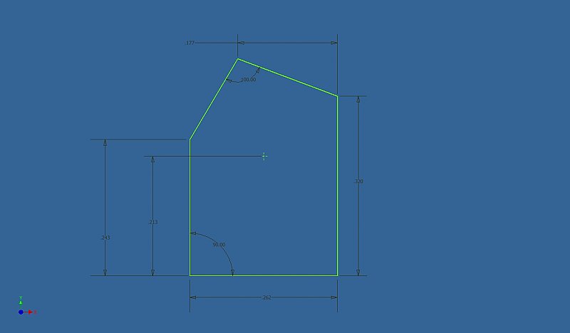

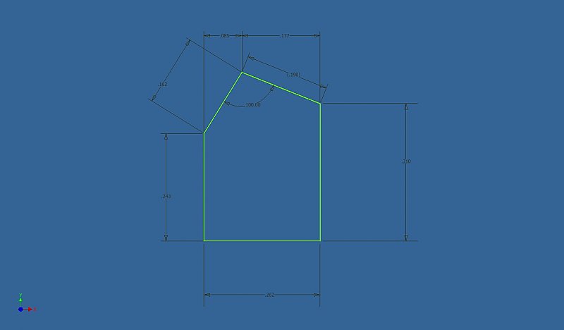

TheJanekGroup Posted July 9, 2010 Author Share Posted July 9, 2010 Here are some measurements - Accidently named this file incorrectly, these are the measurements for the Button Part. These are a bit more detailed then my prior sketch. Quote Link to comment Share on other sites More sharing options...

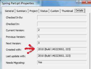

JD Mather Posted July 9, 2010 Share Posted July 9, 2010 I have inverntor 10? Looks like 2010 to me, not 10. There are 3 Service Packs that you should download and install. Quote Link to comment Share on other sites More sharing options...

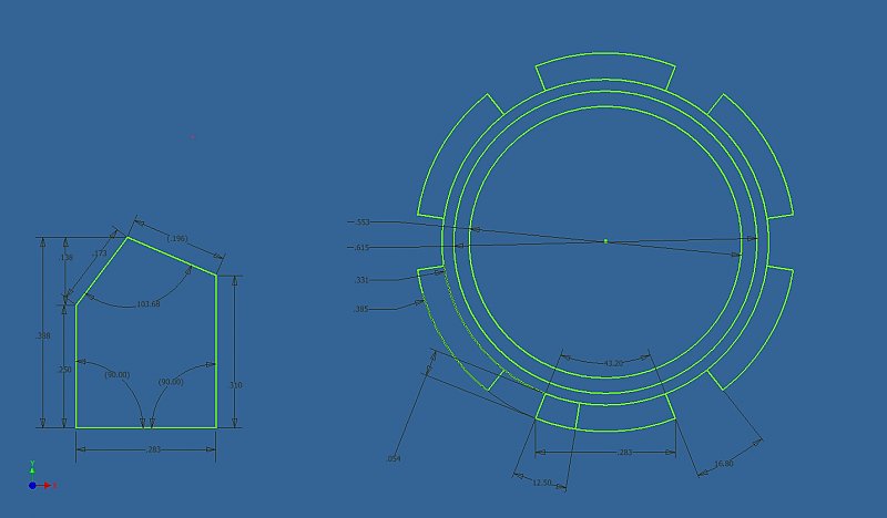

TheJanekGroup Posted July 9, 2010 Author Share Posted July 9, 2010 Ill have the spring part measurements sketch in just a moment, its a bit more complex. Quote Link to comment Share on other sites More sharing options...
JD Mather Posted July 9, 2010 Share Posted July 9, 2010 While I am modeling the Spring Part start a brand new file. I'll walk you through creating the Button Part. Create the sketch as shown (it should turn dark when fully constrained). Post a screen capture when completed. Quote Link to comment Share on other sites More sharing options...
TheJanekGroup Posted July 9, 2010 Author Share Posted July 9, 2010 Yes, it is 2010. Quote Link to comment Share on other sites More sharing options...

JD Mather Posted July 9, 2010 Share Posted July 9, 2010 ok. Ill create this sketch, just one minute Wait a minute - I thought the second sketch you posted was the spring part. I need those dimensions - as you saw I already completed the button part. Get those to me and then go back and start over on the button per my instructions. Quote Link to comment Share on other sites More sharing options...

JD Mather Posted July 9, 2010 Share Posted July 9, 2010 Got it done. Doesn't look fully constrained. (You might want to go back and read the documents I linked earlier.) If you click and hold while dragging a corner does it stay put or does it move? Quote Link to comment Share on other sites More sharing options...
JD Mather Posted July 10, 2010 Share Posted July 10, 2010 ... I am in a hurry to get this done.... Where did you go? You were about done with the first part. About a 15 minute job (less with my step-by-step). Spring part proceedure very similar. Quote Link to comment Share on other sites More sharing options...
