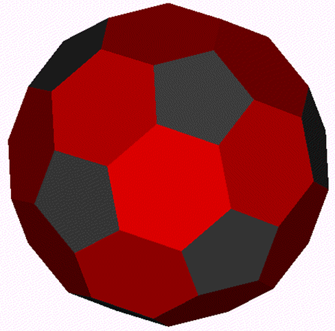

turbeauxpete Posted July 9, 2010 Posted July 9, 2010 Hello all; I'm fairly new to autocad. I'm trying to construct an object (like a cube) made of pentagons. I originally thought it would be pretty straightforward, but all my attempts have ended in failure. I get lost in the UCS/WCS, if thats really the way to do it. I can get it laid out on a flat surface, but can't seem to get it to wrap together. I've seen a similar object but cannot figure how to make it work. Could anyone point me in the right direction? TIA Confused in Houston Pete:? Quote
JD Mather Posted July 9, 2010 Posted July 9, 2010 I'm trying to construct an object made of pentagons. Something like this? Quote
turbeauxpete Posted July 9, 2010 Author Posted July 9, 2010 Yes, only with 5 sided surfaces. How is that done? Pete Quote
SEANT Posted July 9, 2010 Posted July 9, 2010 Dodecahedron, perhaps. Attached done with multiple SLICE operations. Dodecahedron.dwg Quote
turbeauxpete Posted July 9, 2010 Author Posted July 9, 2010 GREAT! What shape did you start with, a sphere or a box or does it matter. Why didn't I think of slice? Quote

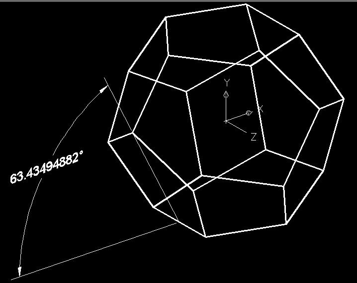

SEANT Posted July 11, 2010 Posted July 11, 2010 The angle is actually closer to 63.5 (See image). I used a process similar to the one shown in post # 16 shown in this thread to derive the angle. http://www.cadtutor.net/forum/showthread.php?t=29863 Quote

CALCAD Posted July 11, 2010 Posted July 11, 2010 turbeauxpete, After playing with the geometry a bit, I can tell you that the angle from baseline required to match the edges is close to 63.434949 degrees, but since I haven't done the work, I can't tell you that repeating that pattern will result in a closed polyhedron. Good luck. Quote
turbeauxpete Posted July 13, 2010 Author Posted July 13, 2010 :?YAHOOOOO! Attention SEANT (thanks) Hardheadedness pays off. I finally got it. I did cheat somewhat, but in the workaday world, time is money. Step 1. (for those who care) Draw an inscribed, by center, pentagon of any radius. Step 2. Draw five more pentagons by edge, attached to the original's edges. Step 3. Using "ROTATE3D" not the "3DROTATE" gizmo. Select an adjacent pentogon and rotate up by 2 points (63.43494882 deg.). Pos. or neg. depends on how you select the 2 points of axis between the original and adjoining pentagon. (left to right is pos. right to left is neg.) *Continue this for all five adjacent pentagons, after which all six pentagons should form a bowl. Step 4. Mirror the "bowl" 180 deg. saving the original. Switch to Top view and rotate the mirror image 36 deg. (either direction). Step 5. Finally. select top "bowl" and move it to join bottom "bowl" like the jaws of a bear trap. I'm not sure as to how to derive the 63.43494882 degs, but it works. As for 36 degs., that is half of 360 divided by 5 (72 deg.) Sorry for the long post, but I retain things better if I force myself to write details down or be able to explain them to someone else. Besides someone else may be just as confused as I. Thanks again to SEANT Learned a lot in Houston Pete Quote

SEANT Posted July 14, 2010 Posted July 14, 2010 This is how I derived that angle (see attachment). It was the same process used in that link I posted earlier, but, having looked at it again, that link wasn’t all that informative. This new attachment has some of the intermediate steps. AngleCalc.dwg Quote
turbeauxpete Posted July 14, 2010 Author Posted July 14, 2010 Wow! but Darn; OK - Again thanks to SEANT. 1. I duplicated the revolve and intersection operations just fine. The outer edge of the remaining intersection section is indeed 63.43494882 degrees. So far so good. (BTW: this method works for apparently any shape having an odd number of sides, I have tried 3 others.) 2. With that said, I can do a "ROTATE3D" command, selecting an outer pentagon and selecting 2point for a baseline of the common edge between the outer and original pentagon. as shown in the attached drawing. By specifying a rotation angle of 63.43494882 and enter, the rotated solid alings perfectly to the intersection object. I can continue this procedure around the original alinging perfectly. 3. Where I'm running afoul is when I try to use the reference choice of rotation angle aaaannnndddd ~~~~~~~~~~??? not being being able to accomplish much from there. I mean I can do many things, other than snap to that point. It would be so much more efficient to just select the top of the outer edge of the interection object and have the said pentagon just go there. What am I doing wrong after all this learning? It's like showing up to class without a pen or pencil. I hope I have been clear as to what my stumbling stone is. I hope it's not a ucs thing, I'm still lacking (but learning) in that area. Oh well, thanks for reading my essay. I hope you can open my eyes Very hot in Houston Pete OngoingDodecahedronThread.dwg Quote

SEANT Posted July 14, 2010 Posted July 14, 2010 The “Reference” option of the Rotate3d command has always been a bit spotty. I used the Section command to avoid the need to use 3dRotate, or realign the UCS to use the standard rotate with reference option. Is the intention to do this type of operation for more shapes/-hedrons? It is a rather unusual task. Quote
