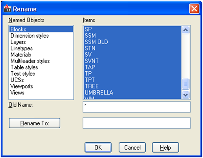

YZ Posted July 26, 2010 Author Share Posted July 26, 2010 Can anyone confirm if the same principle will work for RENAME command? I can get it to run in the command line, but it won't accept *. My macro so far looks like ^C^C-rename LA * SYM_*; (Trying to add the prefix SYM_ to every layer). I can do this successfully in the dialog box - see attachment showing all blocks highlighted when using the * in the "Old Block Name" field: Quote Link to comment Share on other sites More sharing options...

alanjt Posted August 5, 2010 Share Posted August 5, 2010 You can prefix all layers from the Rename dialog. Select "Layers" in "Named Objects" list. In "Old Name" text section, type "*". In "Rename To" text section, type "PREFIX-*" and hit enter. Quote Link to comment Share on other sites More sharing options...
YZ Posted August 5, 2010 Author Share Posted August 5, 2010 Thanks Alan. I do understand how to do this at the command line. The difficulty is that it does not behave the same once that is in a macro. It just says "Layer Selection Invalid". Can you confirm if it works for you inside a macro? Quote Link to comment Share on other sites More sharing options...
alanjt Posted August 5, 2010 Share Posted August 5, 2010 Much unlike Rename, -Rename will only work with one layer/block/etc. at a time. It's about the only commandline version of something that is crippled. Quote Link to comment Share on other sites More sharing options...
YZ Posted August 5, 2010 Author Share Posted August 5, 2010 Ahaa. Well, I must have been remembering -layer that could accept * at the command line and perform multiple changes at once. Oops. That confirms that it will not ever work on a macro! Thanks Alan. I will contact Autodesk about this and see if it can be changed. Quote Link to comment Share on other sites More sharing options...
