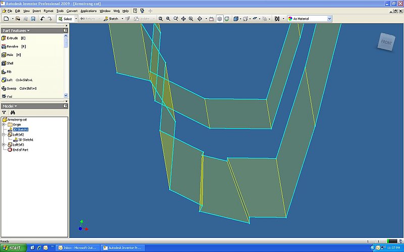

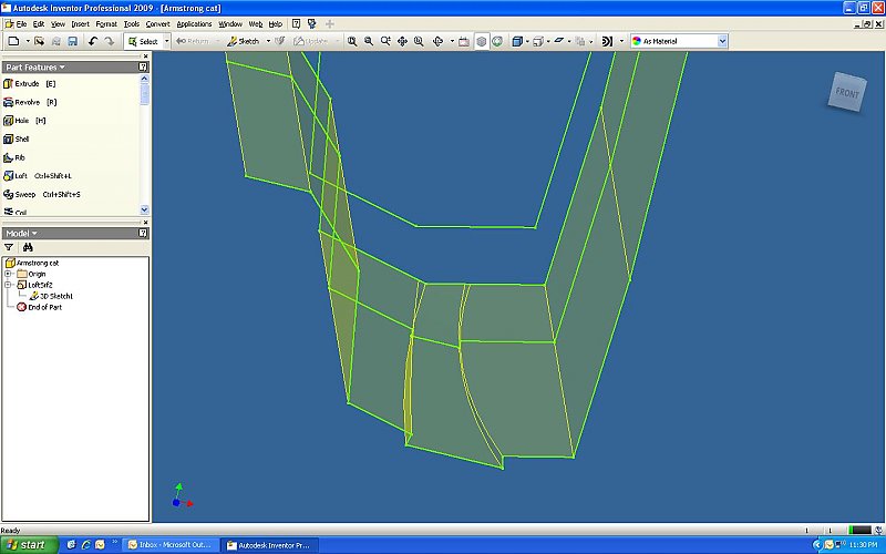

I am working on a catamaran boat hull using lofts for a college drafting project, this is a part of the hull bottom. The loft is not the way I want it. In the first picture I have close to what I want the loft to look like. I want the loft to complete the middle section with the triangular shape down to the single point. In pictures 2 and 3 this is what the loft is doing, and that is not what I want.

You have a different amount of section points between your two sections, so you have to tell the loft feature where you want the shared point to be. Edit the loft feature, select the "Transition" tab and redefine the vectors between the section set points. Pick the points that are locating in the middle of the section line and drag them to the vertice that will be the point of your triangle.
