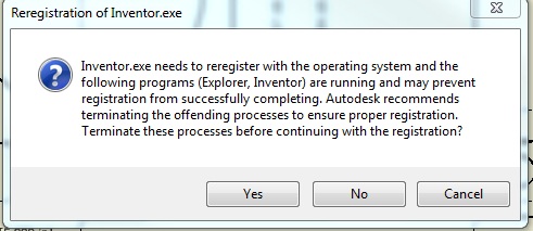

gargoyle27 Posted July 14, 2010 Share Posted July 14, 2010 So i went to use the "pack 'n' go" feature so i can send an entire machine assembly to a customer but i got a weird error, can anyone tell me how to fix this? see attached picture Quote Link to comment Share on other sites More sharing options...
gargoyle27 Posted July 15, 2010 Author Share Posted July 15, 2010 i still really need help with this, someone has got to know what do to Quote Link to comment Share on other sites More sharing options...
jdits7 Posted July 15, 2010 Share Posted July 15, 2010 Usually when I get this error message is when I first start running an upgrade or am switching between releases. Depending on what I am working on and what it is asking me to close is wheather I hit Yes or No. Quote Link to comment Share on other sites More sharing options...
gargoyle27 Posted July 15, 2010 Author Share Posted July 15, 2010 i have never had any other version installed on this computer since the hdd was reformatted, and it only had sp1, i got sp2 now and it didn't change and it doesn't matter if i click yes or no, it still won't let me pack n go Quote Link to comment Share on other sites More sharing options...

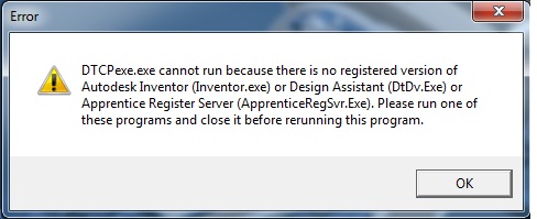

gargoyle27 Posted July 15, 2010 Author Share Posted July 15, 2010 ok, so it turns out that error message i posted wasn't the main one i was worried about, it's this one, this is the one that comes up at the time i mentioned, see attached picture Quote Link to comment Share on other sites More sharing options...

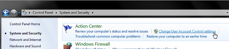

MarkFlayler Posted July 15, 2010 Share Posted July 15, 2010 Is your UAC turned off? Quote Link to comment Share on other sites More sharing options...
gargoyle27 Posted July 15, 2010 Author Share Posted July 15, 2010 i have no idea, how would i find out? Quote Link to comment Share on other sites More sharing options...
MarkFlayler Posted July 15, 2010 Share Posted July 15, 2010 Go here if in Windows 7. Turn it off, restart machine and try again. It may be that Windows can't launch proper security for how this part of Inventor works. Adjust the setting in the UAC to the lowest one. Quote Link to comment Share on other sites More sharing options...
gargoyle27 Posted July 15, 2010 Author Share Posted July 15, 2010 well i tried that, turned it down to the lowest setting and i'm still getting the same error message, any other ideas? Quote Link to comment Share on other sites More sharing options...
MarkFlayler Posted July 15, 2010 Share Posted July 15, 2010 Well I thought that would have helped. This should be a last resort but, you could reinstall with UAC and antivirus turned off in case something got flagged in the install and registered properly because these were on during install. Can you launch Design Assistant either? Maybe try a Repair of the install with these turned off before a full blown reinstall. Repair = Restores files to factory state Reinstall = completely replaces files Quote Link to comment Share on other sites More sharing options...
gargoyle27 Posted July 15, 2010 Author Share Posted July 15, 2010 design assistant opens fine, i'll see what i can do about a repair install Quote Link to comment Share on other sites More sharing options...
gargoyle27 Posted July 15, 2010 Author Share Posted July 15, 2010 edit: never mind, repairing now... Quote Link to comment Share on other sites More sharing options...
gargoyle27 Posted July 15, 2010 Author Share Posted July 15, 2010 ok, it worked, thanks for your help Quote Link to comment Share on other sites More sharing options...
