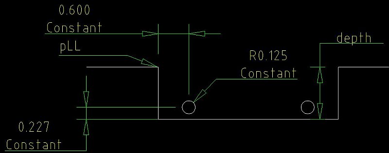

Say you have a list in autocad. It is a point on the screen (10, 10, 10) and its variable name is pLL. I want to use the point as a reference for drawing a circle 0.6 to the right, and a user defined variable 'depth' minus 0.227. See the attached file for a better picture. This is what I am trying and it isn't working for some reason.

I have also tried to extract each number from the pLL list seperatly, do the math, but am not sure how to put it back into a list to use as a mid-point for a circle.
(setq ax (- 0.6 (car pLL)))
(setq ay (- depth 0.227 (cadr pLL)))
These work to get the math done, but I need to rebuild a list and draw a circle on that coordinate.
