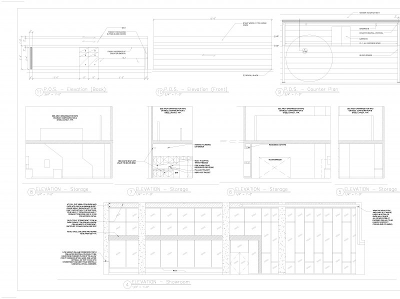

M29 Posted July 22, 2010 Posted July 22, 2010 When I go to plot my sheets, these random lines appear (they continue along the bottom edge of each no-plot viewport). Any ideas? Thanks a mil. Quote

M29 Posted July 23, 2010 Author Posted July 23, 2010 I've attached a jpeg of my issue. See all these viewports? They all have a line along the bottom edge of the "no plot" viewport layer outline. Quote
Dana W Posted July 23, 2010 Posted July 23, 2010 Nope - That's different than I was refering to. Not sure what you have there. Do your viewports overlap by any chance? I tried to recreate it in one of my drawings to no avail. Can you attach your drawing? Someone might be able to find what's up by poking around in it. You can copy it to a new drawing and delete the title block info for privacy, if you want. Quote

Dana W Posted July 24, 2010 Posted July 24, 2010 Sorry, its a day off. I tried a plot to a pdf. It showed no whacky lines. Maybe it is how your plotter driver and/or the 4 year old software reacts to the edges of the viewports. There seems to be a positional relationship between the random lines on your jpg and the bottom edges of your viewports. Not being able to re-create the issue, leaves me in the dark. I am still clueless beyond this point. Quote

Dana W Posted July 27, 2010 Posted July 27, 2010 Wow. Thanks for looking into this Dana. I wonder if there is anyone else that has seen these random lines, that don't have an apparent origin.... WEIRD. I have had similar lines appear on a job about 2 years ago using acad 2007. That is why I had an interest in your thread, but my problem was that my viewport edge was outside the printable area of my paper, so either autocad or the plotter created an edge or frame where I went out of bounds. Can you mate your viewports up adjacent to each other, make them touch, without revealing any more of model space than you want? Since the weird lines have the same amount of vertical displacement from each other as the bottom lines of your viewports do, I am thinking somthing is confusing autocad about where the edges of your viewports are. Quote
