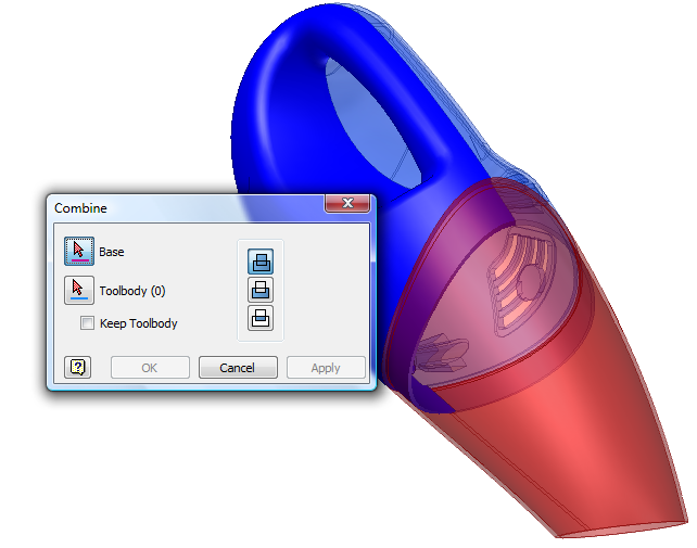

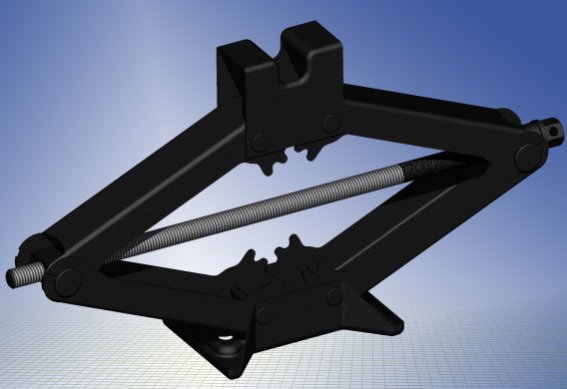

JD Mather Posted July 25, 2010 Share Posted July 25, 2010 Here is an example of how multi-body solids can be used in Inventor. In many assemblies the geometry across the parts in the assembly follows a continuous flow. It makes logical sense to model in a single file then push out the individual parts if desired. Quote Link to comment Share on other sites More sharing options...

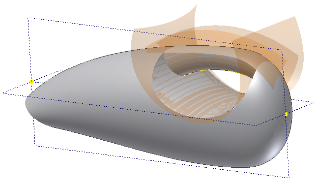

JD Mather Posted July 25, 2010 Author Share Posted July 25, 2010 Surfaces, solids and imported geometry can be used to create the finished design. Quote Link to comment Share on other sites More sharing options...

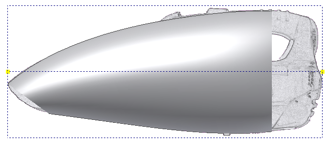

JD Mather Posted July 25, 2010 Author Share Posted July 25, 2010 Reproduce the artists basic idea with geometry, say a Loft feature. Quote Link to comment Share on other sites More sharing options...

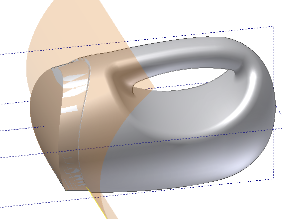

JD Mather Posted July 25, 2010 Author Share Posted July 25, 2010 Use surface bodies as appropriate to edit solid bodies. Quote Link to comment Share on other sites More sharing options...

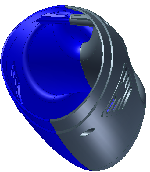

JD Mather Posted July 25, 2010 Author Share Posted July 25, 2010 You can either model multi-body solids directly as you create the design, or split monolithic solids into multi-body solids. Here stitched surfaces are used to Split a solid into two solids along a complex split line (one part hidden for visibility). Quote Link to comment Share on other sites More sharing options...
JD Mather Posted July 25, 2010 Author Share Posted July 25, 2010 Continue spliting and detailing additional features - like the mating hole and thread bosses for connectors - all in one ipt file. Quote Link to comment Share on other sites More sharing options...

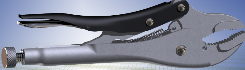

JD Mather Posted July 25, 2010 Author Share Posted July 25, 2010 Here are some other examples of "assemblies" modeled as multi-bodied solids in one part file. And because Sketch Blocks were used the 2D kinematics of the motion could be tested while still in one ipt file. Quote Link to comment Share on other sites More sharing options...
