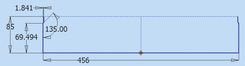

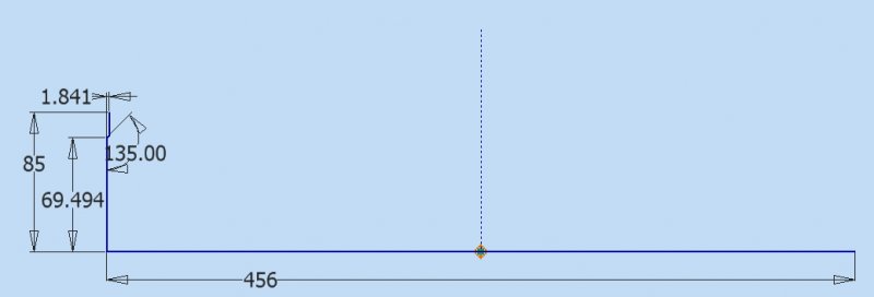

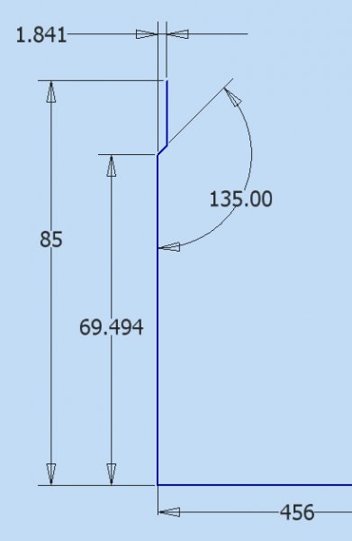

JD Mather Posted August 6, 2010 Posted August 6, 2010 hi JD....i have tried to do as u said..i hope i have done it right.... Now on the left end of that line create the three lines shown and dimension as shown. Quote

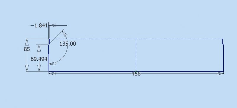

JD Mather Posted August 6, 2010 Posted August 6, 2010 Create the vertical construction line at the origin as shown in attached image. Quote
JD Mather Posted August 6, 2010 Posted August 6, 2010 Mirror the three lines from the left side to the right side using the construction line as the mirror line. Quote

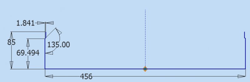

JD Mather Posted August 6, 2010 Posted August 6, 2010 I don't leave anything hanging unconstrained, so create the horizontal construction line between the top of the mirrored entities and trim the vertical construction mirror line. Attach the file as you have completed so far. Quote
nikhil Posted August 6, 2010 Author Posted August 6, 2010 here's jpeg file also.....i hope i have done it right Quote

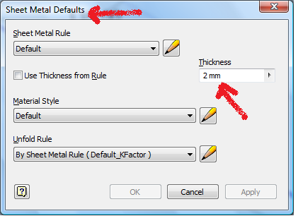

JD Mather Posted August 6, 2010 Posted August 6, 2010 Opening your file it doesn't look like you started from Sheet Metal template - not a big problem. Find the Convert to Sheet Metal icon or drop down from menu (I don't recall the location in 2008 ). Then select the Sheet Metal Defaults and set the Thickness to 2mm (your dialog box might look a bit different than attached.) Quote

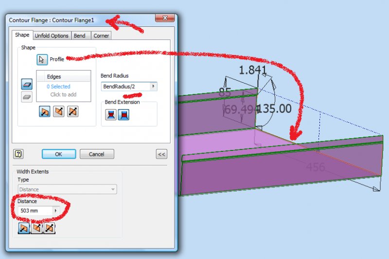

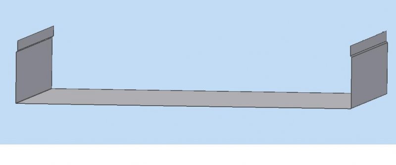

JD Mather Posted August 6, 2010 Posted August 6, 2010 Select the Contoured Flange tool and then select the Sketch1 we just completed. Set the BendRadius to BendRadius/2 Set the Distance to 503 and then click OK. The Contoured Flange tool is a very power tool that many neglect to use. Actually I would do the part differently in 2010 or later as even more functionality was added to Contoured Flange that would simplify this part. (Your dialog box might look a bit different than mine.) Notice that with Contoured Flange we need only a single line profile of our overall basic shape (no thickness - Inventor adds that). As I type this I just realized that I forgot to set the thickness to the correct direction in the dialog box. Make sure it Thickens towards the inside of the sketch as the sketch is our overall outside dimensions. Notice also that Inventor also added our bend radii. (By default inside bend radius = material thickness. For a tighter bend we divided by 2.) I've got to do a bit of other work - I'll be back later to continue with the part (after this part you should be able to do whatever dimensions and features you need). Quote
