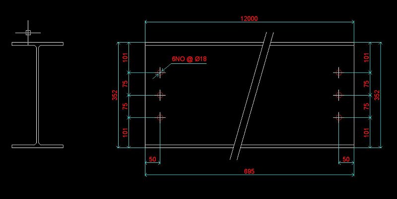

iF IT WAS A BEAM YOU COULD DO SOMETHING SIMILAR TO THIS TO CUT DOWN ON THE PAPER SPACE USED.
THE 695 SHOWS THE ACTUAL SIZ I HAVE DRAWN THE BEAM AT. (DONT PUT THIS ON YOUR DRAWING)
THE 12000 DIMENSION WAS CREATED USING A TEXT OVERIDE OF THE DIMENSION.
