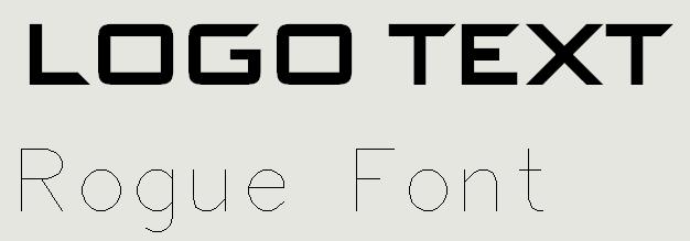

memphis710 Posted July 30, 2010 Author Posted July 30, 2010 Dave, Font created using on the rogue machine appears incorrect too. I have reinstalled the font in question through windows several times now (just to save confusion, the font is based on Bank Gothic so there is not much like it in terms of style and font name) I have attached a pic a the two fonts. The rogue font is the same as the Logo but after being exploded. Cheers Ollie Quote
memphis710 Posted July 30, 2010 Author Posted July 30, 2010 Eldon, Using textexplode seems to have done it thanks (on my machine anyway.... just need to update server version of the template!). Haven't really used express tools much before so will start having a play round with its other toys! Will keep you posted if it sorts the rogue machine problem! Cheers Ollie Quote
