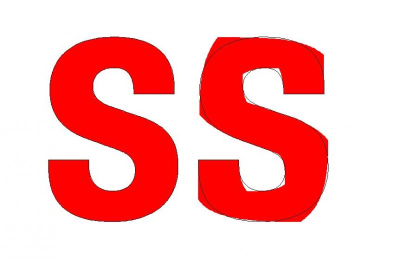

Hello,
I am having a problem where if I copy certain hatching which is bounded by a spline,the copied hatch is dostorted:
The hatching to the right is the copied one.
I cant seem to replicate the problem and it only happens to certain hatces.
I tried creating a block before copying, but dosent help.
Has anyone else come across this problem?
Looks like an arc resolution problem with the spline; the copied hatch looks like it is folowing a spline with less segments.
Are you using the Whip! display driver? That can often give this kind of problem.
Just in case try typing (in Autocad)- WHIPARC 0
That will turn off Whip!, now try the copy again.
