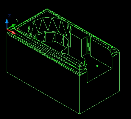

Hey,
I have a model of a block. All the curved surfaces have line to show the surfaces. I just want to show th edge lines and not the surface lines. How do I do that?

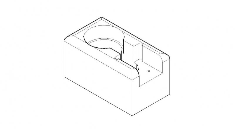

This is what I am trying to accomplish.
This was done by previous draftman and put into an assembly. I have tried all settings posted here and still can't get rid of the lines. It looks so much cleaner without the lines.

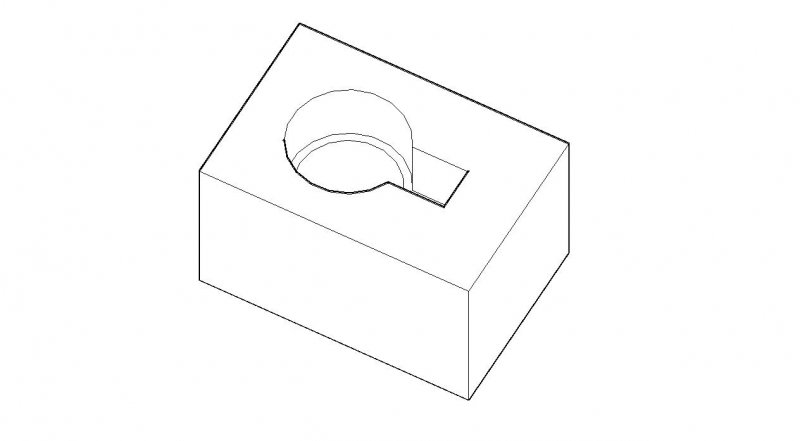

DISPSILH set to 1. 3DHidden view yields this:
