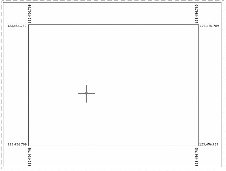

I create maps that are registered with our land registry authority. They have a requirement that all maps indicate in Coord format the extents of the map window (see image attached). The thing is that the coords are to be in paperspace but relative to the extents of the viewport in modelspace. So that if I pan around inside the viewport and regen the coords they update.
How would I best go about this? Can it be done using fields? I have looked at the VSMAX and VSMIN variables but I don't think that is correct because the values seem way off.
I just had a thought that maybe I could do it by using VIEWCTR and that viewport scale to calculate the extents and write them out to block attributes..
Anyone done anything like this before???

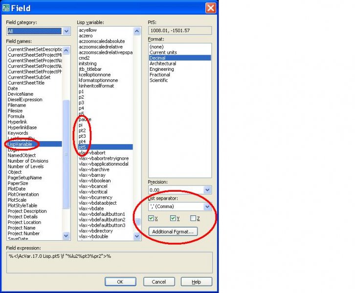

I have created a block with attributes in place of the coords in the top image. How to I update the attibutes?
I see from the above code that the coordinates are savead as the variables PT2-PT5. If you were to "de-localize" them, you could use fields in your attributes (Field Name > LispVariable). You'd need to run the lisp and regenerate each time you want to update.
What do you mean by "de-localise" them? How do I go about setting it up to use LispVariables? Do I need to create new LispVariables within CAD? Is ti something to do with Diesel expressions?
When a variable is declared local, it's value is returned to it's original value once the lisp routine has finished (most likely nil). If it is not declared, it retains the value it was assigned during the routine. A variable is localized when it is after the / in the expression immediately after the the (defun... the variables in red below
(defun C:VBORD(/ [color=darkred]CLAY2 PWID2 X_CEN YCEN SCRHGT X_DIM Y_DIM XY_RATIO PIX_RATIO
                SCRWID LEFTEX RIGHTEX BOTEX TOPEX PT2 PT3 PT4 PT5[/color]
if you remove them from the expression you can use them in a field
                SCRWID LEFTEX RIGHTEX BOTEX TOPEX[/color]); PT2 PT3 PT4 PT5
I made a quick dwg using fields with LispVariables. You'll need to run the lisp routine (after removing the variables from being localized) and then do a regenall.
Be aware that this will only work for 1 viewport at a time.
hope it works for you
