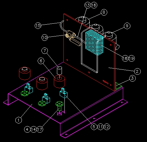

jbird68 Posted August 18, 2010 Posted August 18, 2010 I have a drawing that was created using ACAD 2004. But I am unable to figure out how it was created. I could use a little help figuring out how it was done. This is actually inserted into a 2D drawing with a border. Quote
Dana W Posted August 18, 2010 Posted August 18, 2010 Maybe it was drawn as a 2D isometric. Must be, the sides are parallel, no vanishing point(s). Quote
Cad64 Posted August 19, 2010 Posted August 19, 2010 I have a drawing that was created using ACAD 2004. But I am unable to figure out how it was created. I could use a little help figuring out how it was done. This is actually inserted into a 2D drawing with a border. Can you post the drawing here? I have my doubts as to whether it's actually a model or just an isometric drawing. Although it could be a model with the viewport set to display as 3DHidden. But I'm not sure if 2004 had that capability? Must be, the sides are parallel, no vanishing point(s). Not necessarily. You can get that same appearance by viewing a 3D model in isometric view. The only time the sides won't be parallel is if you're viewing the model in Perspective. Quote
jbird68 Posted August 19, 2010 Author Posted August 19, 2010 This is the file. I noticed that the you can select the lines individually, so it has been exploded. I have other drawings where when you double click on the isometric view, it brings up a window saying it is a pictoral object. I just am not sure how teh previous draftsman created it. There are some things like a Destaco clamp that I can't see anyone drawing in 2D isometric. That is in the T890 drawing also attached. isodrawing.dwg T890-02-20567s1a.dwg Quote
RobDraw Posted August 19, 2010 Posted August 19, 2010 The T890 drawing looks like it was a 3D model and then partially flattened and hidden lines removed. I'm guessing that the other drawing was done in 3D also and then flattened in the same way. Quote
jbird68 Posted August 19, 2010 Author Posted August 19, 2010 I would just like to know how to flatten a 3D model so I could use it in representations like I have shown. Can you convert a 3D to a 2D drawing? And if so, how do you choose the correct perspective. I've tried copying the isometric view intoa 2D drawing but when I paste it into the drawing I always get either a front or top view...not the isometric view. Quote

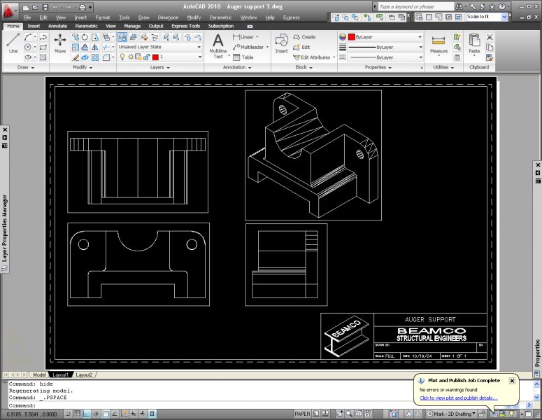

ReMark Posted August 19, 2010 Posted August 19, 2010 An example of a multi-view drawing created using Solview/Soldraw. Viewports were intentionally left visible to show they are separate views. Quote
ReMark Posted August 19, 2010 Posted August 19, 2010 (edited) This was drawn in 3D? The 2D profiles you see in the above image were created from a single 3D object. I had a copy of 2004 handy so I loaded it up. The Flatshot command I mentioned having used to create the isometric of the bobbin is definitely not a recognized command. Edited August 19, 2010 by ReMark Quote
