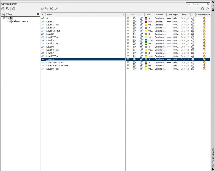

Acad_2010_user_NL Posted August 19, 2010 Author Posted August 19, 2010 my layers does have spaces here is a picture of my layer manager Quote
Tharwat Posted August 19, 2010 Posted August 19, 2010 OK. I am sorry Layer name nowadays accept space within . Anyway I tried it in mine and it does work also with space, like this : (sssetfirst nil(ssget "_x" '((0 . "TEXT,MTEXT")(8 . "Layer 1")))) So copy it, and change Layer name only . Quote
