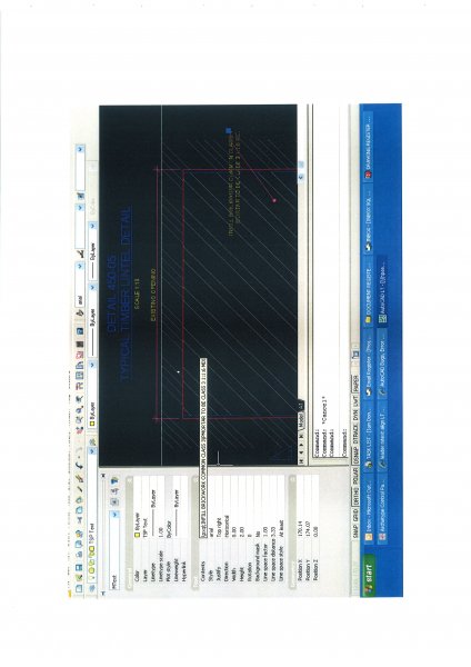

Hopefully someone else has come across this problem. We are using a (legal) mix of LT2004, LT2007 & LT2008 and have been experiencing problems with the leader text justification going a bit crazy. In fact I think it is happening to any text that was created from a Leader Mtext. We need to save all drawings as LT2004 to allow everyone to read the drawings, however any drawing that has been a leader added and saved in LT2008 and then opened by an older version causes the text justification to the right justification. The text also displaces itself approx 15mm to the left but in the Mtext editor all apears okay. Also in the properties toolbar (CTRL+1) the text section indicates in the content "/pxql;" is present in the text formating.
