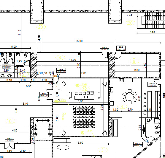

gpktm Posted September 11, 2008 Share Posted September 11, 2008 I have a problem with one of my layers. It doesn't get black. In plot style talbe, I chagend the option into monochrome.ctb but one of the layers are still in yellow colour. Can anyone help me please? Quote Link to comment Share on other sites More sharing options...
