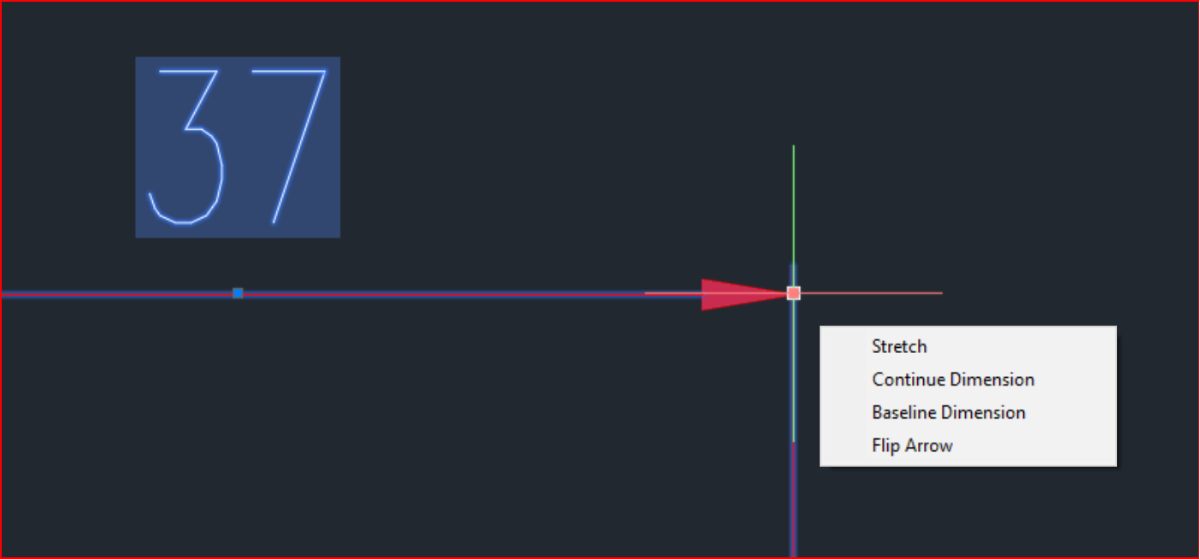

RobDraw Posted September 9, 2010 Share Posted September 9, 2010 Got it. Select the dimension, right click, then select "Flip Arrow". Where you select the dimension determines which arrow head will flip. Quote Link to comment Share on other sites More sharing options...

Seneca Posted January 16 Share Posted January 16 aidimfliparrow Quote Link to comment Share on other sites More sharing options...

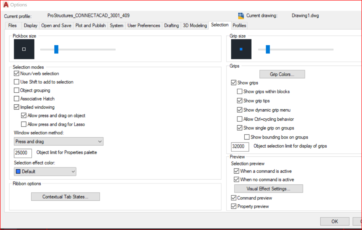

Dadgad Posted February 3 Share Posted February 3 If you have your dynamic GRIP menus enabled, in OPTIONS > Selection tab. Do it like this... Quote Link to comment Share on other sites More sharing options...
Dadgad Posted February 3 Share Posted February 3 On 1/17/2024 at 4:09 AM, Seneca said: aidimfliparrow Welcome to the CadTutor forum Seneca, nice one. Quote Link to comment Share on other sites More sharing options...
