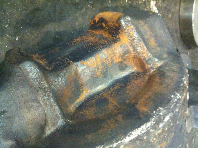

JPlanera Posted September 16, 2010 Posted September 16, 2010 I’m trying to draw a model of a part, using the original 2d sketch and a picture... I am having a hard time figuring out how to blend all these corners and included drafts. I am self taught with this software and probably over my head with this. I’ve done most of the online tutorials and visited all the forums, but nothing seems to relate to my part... Im pretty sure i am going about this the wrong way.. should i be using surfaces instead?? This is a quick "throw together" of sketches i am just pulling off the dwg. so not much has been put in to Inventors sketch constraints. Once I figure out how to blend everything together, i will go back and re do it all properly. The attached picture is from an old worn out part, and in the end, the new part just needs to "look" right. Any help is appreciated. I’ve also attached the dwg and my ipt file. part.zip orig2d.dwg Quote

JPlanera Posted September 16, 2010 Author Posted September 16, 2010 JD, i am not offended. I am only throwing this together for argument sake... I am a perfectionist, so believe me, leaving sketches hanging like that makes me lose sleep at night! HA! @shift: Thank you for reiterating my statement. Yes, i am reproducing an out dated part, so to speak... The part is worn out and no longer produces quality product, so we need a new one.. the problem is, the machine shop can not interpret the drawing. So to avoid them "guessing" i want to do the guessing for them... Once i figure out how to accomplish all the complex blending, I am going to start from scratch and do it right. (which is why, again, everything is garbage at this point) Right now, i want to make the part just at least "look" like the picture. In the end, the machine shop will use my model for machining... Quote

shift1313 Posted September 16, 2010 Posted September 16, 2010 Just a thought for you. The piece in your picture is cast. If you will be machining it, you will not need to copy everything, and for manufacturability sake it may be easier if you dont. Is this a form of some sort? If so i understand the need to replicate it, but if not you may be able to get away without that level of detail. Quote
JPlanera Posted September 16, 2010 Author Posted September 16, 2010 @ JD: I like the sound of that!! @shift: Unfortunaltely it is not a casting. I can see how you would think so by looking at the picture. It is a forming tool for a forge, so it has been exposed to a lot of heat and abuse giving it that "cast" look... The level of deail can be debated. The final product has some wiggle room, but id like to try to stay as close to the "print" as i can Quote
JD Mather Posted September 16, 2010 Posted September 16, 2010 @ JD: I like the sound of that!! @shift: Unfortunaltely it is not a casting. I can see how you would think so by looking at the picture. It is a forming tool for a forge, so it has been exposed to a lot of heat and abuse giving it that "cast" look... The level of deail can be debated. The final product has some wiggle room, but id like to try to stay as close to the "print" as i can Always good to know a bit more information about the part. I thought it was a casting from the pic (didn't take a good look at the 2d dwg yet). Quote

shift1313 Posted September 26, 2010 Posted September 26, 2010 I played around with it for a little while yesterday and some this morning. Something isnt adding up with the dwg and how some of the edges meet(in comparison with the image you posted). I would think with inventor it would be much much easier to draw the final part and use that to make the die. When i get the time ill play around with it a bit more and let you know if i get anything usable. Quote
JPlanera Posted September 27, 2010 Author Posted September 27, 2010 I played around with it for a little while yesterday and some this morning. Something isnt adding up with the dwg and how some of the edges meet(in comparison with the image you posted). I would think with inventor it would be much much easier to draw the final part and use that to make the die. When i get the time ill play around with it a bit more and let you know if i get anything usable. Yes, that was one of the big issues I had. In the end I just needed it to "look" right... Coming from a precision machinist background, you have no idea how much that pains me to say... I took some liberties with the 2d drawing and used mostly inventor to draw the final part. The file i am attaching is mostly a copy/paste sketch geometry from the final product I was able to generate as it is too big to attach... well even trying to consolidate this file, i cant seem to get it below 500KB... something doesnt seem right. Is there a purge optioin, is inventor saving unused legacy data??? Quote
