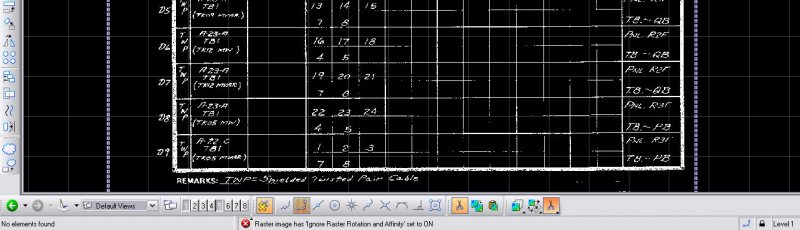

I was just upgraded to XM for V8. In V8 there was a check box to select/de-select apply raster rotation & affinity. In the new XM version I'm unable to find this button and I can't edit my image without changing the setting. Any ideas where I find that option?

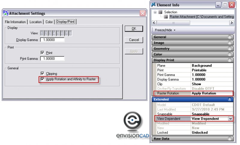

In the Raster Manager dialog double click the file name the Element Info dialog will appear.
Expand the Display Print section.
Set the Raster Rotation to Display Rotation.

I don't believe that is it. I have seen that setting and changed it a couple times, but it didn't seem to let me edit the image still. Any other ideas? Maybe it is a combination of a couple settings? I don't know. The image that I attached says it is set to on, so I'm assuming it is just an on/off thing somewhere. Just haven't had any luck finding it yet.
Lakerz24, you are right there seems to be another setting that can effect the raster display. In the Element Info dialog expand the Extended Settings and set View Dependent to View Dependent.

No luck with that either. The only setting i can see that is different than what your image shows is clip... and that obviously isn't going to be the problem. Thanks for trying to help me out by the way... you got anything else?

Haha, nevermind it looks as though you have solved my problems. I was looking at the View Dependent option and must have just quickly glanced and thought I had that setting right. I just changed that though and it seems to be working now. Thanks for all your help!
