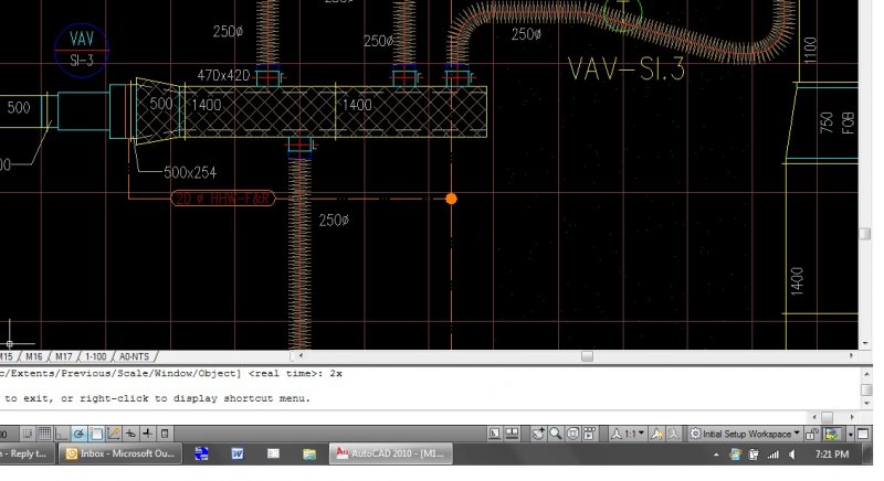

oldsoftboss Posted October 6, 2010 Author Share Posted October 6, 2010 In answer to the questions above. We have a program at our office that allows automation when drawing ductwork. It allows us to draw straights, elbows, bends, transitions etc. Our sheetmetal manufacturer likes internally lined ductwork to be hatched (for clarity in reading the drawings-different hatching represents different thickness of insulation). This program does not hatch the ductwork. The program has the ability to break the ductwork into pre-determined lengths, so if we require 14 metres of duct, it will break it up into 10 1.4 metre lengths. My idea on hatching was to simply draw a rectangle (or polyline) around the entire duct, hatch it and then delete the rectangle (which is what I do manually at present). On reflection, it would have been better to replicate the hatch dialog box, but without having to select Hatch type, Scale, Rotation and ensuring the correct layer every time. Simply type HH, select the object(s) and hatch, so if the duct has a length denoted (see attached image), select the duct (closed polyline), select the length and then hit enter. The duct would not then need to be deleted. I thought once I had one type of hatch up and going, I would edit the code and create different shortcuts for different types of hatches. I have a fair amount of VBA programing experience, so I thought this would be a doddle, but the AutoLisp code is a whole new language and I am struggling big time. Thank to all for your input to date. As you have shown, AutoCAD is only limited by your imagination (and ability!!) Any feed back is greatly appreciated. PS: Lees code, I run ACAD 2010 both at work and home, so go figure?? The only thing I can think of is a dodgy cut and paste job, but never quite got to sit in front of the PC today. Will keep you informed. Quote Link to comment Share on other sites More sharing options...
The Buzzard Posted October 6, 2010 Share Posted October 6, 2010 In answer to the questions above. We have a program at our office that allows automation when drawing ductwork. It allows us to draw straights, elbows, bends, transitions etc. Our sheetmetal manufacturer likes internally lined ductwork to be hatched (for clarity in reading the drawings-different hatching represents different thickness of insulation). This program does not hatch the ductwork. The program has the ability to break the ductwork into pre-determined lengths, so if we require 14 metres of duct, it will break it up into 10 1.4 metre lengths. My idea on hatching was to simply draw a rectangle (or polyline) around the entire duct, hatch it and then delete the rectangle (which is what I do manually at present). On reflection, it would have been better to replicate the hatch dialog box, but without having to select Hatch type, Scale, Rotation and ensuring the correct layer every time. Simply type HH, select the object(s) and hatch, so if the duct has a length denoted (see attached image), select the duct (closed polyline), select the length and then hit enter. The duct would not then need to be deleted. I thought once I had one type of hatch up and going, I would edit the code and create different shortcuts for different types of hatches. I have a fair amount of VBA programing experience, so I thought this would be a doddle, but the AutoLisp code is a whole new language and I am struggling big time. Thank to all for your input to date. As you have shown, AutoCAD is only limited by your imagination (and ability!!) Any feed back is greatly appreciated. PS: Lees code, I run ACAD 2010 both at work and home, so go figure?? The only thing I can think of is a dodgy cut and paste job, but never quite got to sit in front of the PC today. Will keep you informed. Thats just what I thought. Sorry, But I could not resist. Buzzard 1 - 0 Lee Quote Link to comment Share on other sites More sharing options...

oldsoftboss Posted October 6, 2010 Author Share Posted October 6, 2010 Thanks for the feedback. Buzzard, the ducts do appear to be closed LWPOLYLINES, so you are correct, in 90% of cases, no need to delete the duct (or outline) Find attached a selection of objects the program will draw. You will notice the mitred tee is not closed, but I can deal with this. If I could select the duct, select the text, and hatch on the correct layer, I think that would be ace. Also on the drawing are a couple of ducts hatched as they would appear once completed. Drawing1.dwg Quote Link to comment Share on other sites More sharing options...

The Buzzard Posted October 8, 2010 Share Posted October 8, 2010 (edited) Hey Dave, I put a little time into this, But I will need your feedback. I thought Lee had this one and maybe he still does. Not sure. Try this and let me know how its going. I am sure you will be able to modify it easy, If not, I will do my best to fix it for you. I believe the filters are going to need some more work. I do not use them so often, So understand I am still learning too. HH.lsp Edited October 8, 2010 by The Buzzard Quote Link to comment Share on other sites More sharing options...
oldsoftboss Posted October 8, 2010 Author Share Posted October 8, 2010 Works a treat, thankyou thankyou. Quote Link to comment Share on other sites More sharing options...
