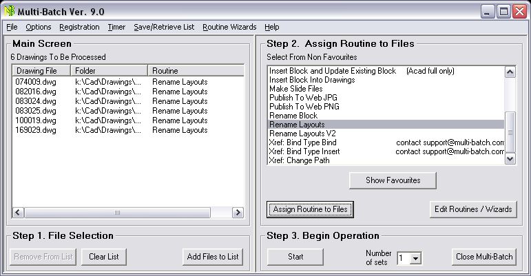

Well, I have found a solution that works quite well, and did not require any further LISP knowledge on my behalf.
The basis was multi-batch, which basically lets you set up a commandline-routine, and then apply this to a whole set of files.
I'm using this program in conjunction with Find/Replace lisp routine mentioned earlier in the thread. It's a very 'dumb' routine, and it can probably be done with more intelligence using a LISP routine with 'if' statements. However, with a bit of cutting and pasting I had the routine below in a matter of minutes, and was able to incorporate a font change while I'm at it.
I basically invoke the TABRENAME.LSP routine 118 times to do just about every possible variation found in our Layout names. It looks like this:

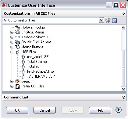

Download the TABRENAME.LSP file (http://www.ramlug.org/index.php?option=com_docman&task=doc_details&gid=18&Itemid=55) and save it somewhere on your computer or network. Make sure that that lisp file gets loaded every time you open a document. You don’t have to edit the lisp code at all.
Not sure how that goes in the Acad version you are using. In Acad 2009 you type in CUI, and add the file to the Lisp – section (see screenshot). You can load it for an individual document by typing APPLOAD and loading the file, but you don’t want to be doing that every single time you open a document.
If the lisp routine is loaded successfully, you should be able to type the command TBR. It will then ask you ‘Find:’ (type in what you want to have replaced), followed by ‘Replace:’

As I mentioned earlier in the thread I bought a program called Multi-Batch 9.0 (www.multi-batch.com). A single user license costs $39. It works brilliantly, because all you need is an understanding of how the command line works. You simply create a command line routine that you want to run on a set of files, then you set the directory containing all your files (it can include files in subdirectories), and you assign your routine to all of these files with one click.

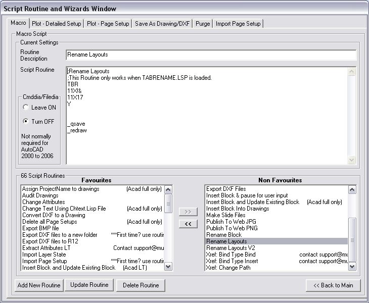

The routine would look something like this:
TBR 11X!& 11X17 Y (Note: Every single space in the routine is an ‘execute’, just like in your command line, which is why spaces were causing me problems in the routine previously)
_QSAVE
_REDRAW (I’m not sure of the significance of this command after the save, but most of the pre-loaded routines have it so I left it there)
Once you hit Start you watch it crunch through your files. The program starts up your own Autocad, opens the file, runs the routine, then saves it. This means it’s not some back-door conversion by a third-party application, which might cause problems with the file.
I’ve processed 25000 files this way, and with the long routine I had assigned to them (see previous page) it did about 20 to 25 drawings per minute. I usually ran it during the day, because every now and then I came across an old dodgy file that had an error (and needed a RECOVER), which would stop the entire process.
Obviously, you do a test run on a few files to make sure the end result is what you want before you do all 5000. There’s a fully functional trial available that’s limited to 3 files per batch.

The line above can simply be combined with the previous routine (after renaming the layout). I'm not really sure about the significance of the underscore in front of commands, but it does seem to work better for certain commands.
