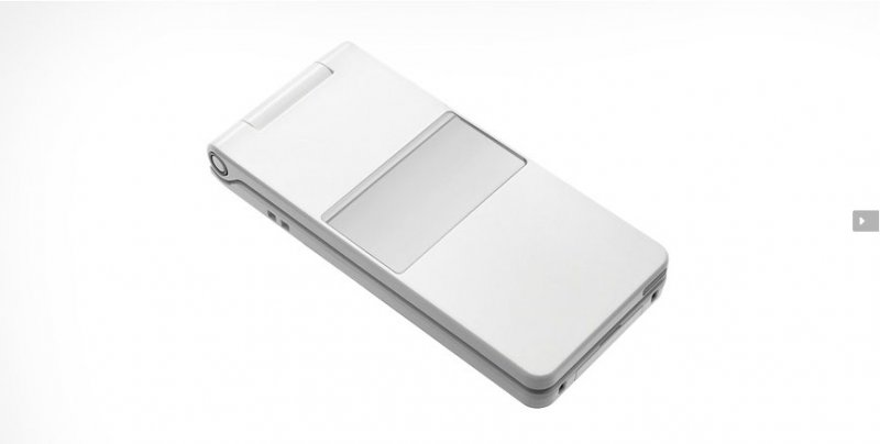

Akatszuki 10 Posted October 7, 2010 He guys, I'm new at 3dsmax and I need some help on modeling this thing . The first pic shows u how smooth it is and i want to know how to make it looks like that ? What I've done so far is showed at the pic number 2 . That cylinder and the box are still 2 different compound, I really need help on these ASAP . > Please tell me how to make it looks like in the pic 1, steps by steps if u will . > Quote Share this post Link to post Share on other sites

Cad64 80 Posted October 7, 2010 and i think i need to use turbosmooth, as part of the assignment . > So this is a school assignment? Have you tried working on this yourself at all since this morning? I'll give you a hint. You have to combine the two objects together into one object before you can smooth the transition. Give it a try and see if you can work it out. Quote Share this post Link to post Share on other sites
Akatszuki 10 Posted October 7, 2010 Yeah, I tried the whole day . ): I used probolean, they became one, but when i use turbosmooth, are all messed up .. I really need help .. Can u help me with the tutorial ? ): I really need one . ): I'm so bad at 3DsMax . T^T It's not a school assignment, it's an assignment made by me, because I like the phone so much . > Quote Share this post Link to post Share on other sites

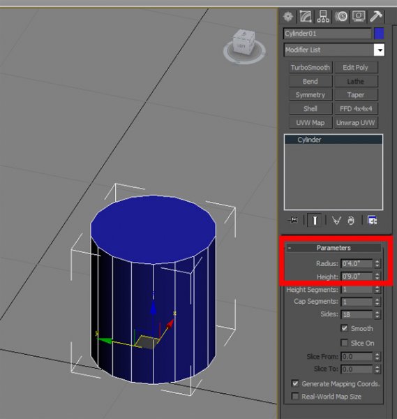

Akatszuki 10 Posted October 7, 2010 Ok, but I'm not going to create a full blown tutorial on how to model the entire phone. That would take a lot of effort. but I will show you how to create the piece that you asked about. I'll put together the tutorial when I get home tonight. I know . >w and one more question . > for example, i want to make the height of the cylinder is perfectly similiar to the height of a box . Ty for ur time ! and sorry for the troubles ! m(_ _)m .. I owe u one !! ^^ Quote Share this post Link to post Share on other sites
Cad64 80 Posted October 8, 2010 Sorry, I started to put together the tutorial and then realized it was going to take a couple of hours to do it right, so I stopped. There are just too many things that you need to learn, and I just don't have the time to teach you everything you need to know. You need to get yourself a book, or a training DVD so you can learn all the basics, then come here to ask questions when you get stuck. It will be very time consuming and difficult for me to try and teach you everything here in the forum. To answer your last question about making objects the same size, just type in the dimensions you want your objects to conform to in the Parameters rollout. If you want to create a cylinder that has a radius of 4" and is 9" tall, just draw out the cylinder and then type in those amounts. See below. Quote Share this post Link to post Share on other sites

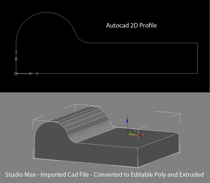

Cad64 80 Posted October 8, 2010 To be honest, if I was going to make that part, I would draw a 2D profile in Autocad, import it to Studio Max and Extrude it. That's the easiest way. Quote Share this post Link to post Share on other sites

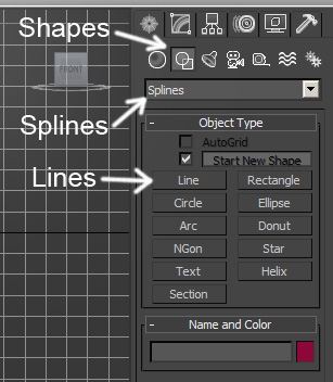

Cad64 80 Posted October 8, 2010 So, in 3dsmax, we using line tool, am I correct ? ): Yes, go to the Shapes panel, select Splines and then you can draw lines, circles, rectangles, etc. Quote Share this post Link to post Share on other sites
Cad64 80 Posted October 8, 2010 If using objects ? Objects? What do you mean? Like a box, cylinder, etc.? Yes, you could construct the shape with those, but it will require a lot more work joining them together cleanly. That's why I stopped on the tutorial, because it was just going to get too involved. Instructions like that are best done with video where you can just watch it being done. It's difficult to explain with just words, and creating screenshots for everything can become quite tiresome. Try drawing the shape with lines and then extrude it and see how it goes. Quote Share this post Link to post Share on other sites
