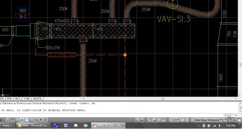

Hi all,
I have a macro
^C^C^P(if (= C:FLXDCT nil)(load (strcat dct_drltr "/dct10/flxdct")))(princ) ^PFLXDCT
that runs from a click on on an icon in the toolbar. I would like to call this from a keyboard shortcut - say N - (doesn't seem to be used for any thing else).
Ideally I would like to tag this macro to the end of an AutoLisp, but that may be a task for another day.
Have played around with customising keyboard shortcuts in the CUI but they all seem to require the shift or ctrl key combinations.
Any feedback would be greatly appriciated.
Dave

Once again Lee Mac - works a treat. Thankyou
How would I go tagging to the end of this lisp?

This lisp creates the flex line. The n lisp puts a zig-zaggy line along it.
It would be great to have this all in one hit.

Yet again you have come to the rescue. Thankyou
I was trying to add the function at the bottom of the code, then call the n function after the other lisp finished, but just kept getting an error no matter which way I tried it.
Who would of thought of simply adding the code to the bottom. :?
Well, its not the ideal way to approach it, but I don't have the other code to incorporate it.
As long as it works I suppose :)
