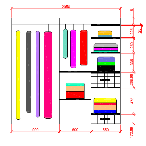

Lone71 Posted October 10, 2010 Posted October 10, 2010 Hi everyone, Im new to autoCAD 2010 and new in here. I´m studying to be an interior designer, and now I have to make an elevation of a closet, with clothes in it. I have tried seaching this forum and on Google, but can´t find the help I need. How do I best do this? Wich tools should I use and so on? Ive made the closet but don´t know how to draw the clothes in it. Thanx... Lone Quote

Lone71 Posted October 11, 2010 Author Posted October 11, 2010 Yes, Ive now come up with my solution, remeber I´m a newbie at this.... Quote
ReMark Posted October 11, 2010 Posted October 11, 2010 It's a good first start but I think it needs to be fleshed out. The vertical dividers should have some sort of width and the clothes poles a diameter right? The handles on the two drawers do not look centered. Are you going to include any vertical dimensions? Some of your hangers don't appear to be on center either. Where would a person put their shoes, boots, slippers, sneakers? See what I am getting at? Did you do any research based on the link and the suggestion I gave you for finding relevant information re: closet systems? Quote

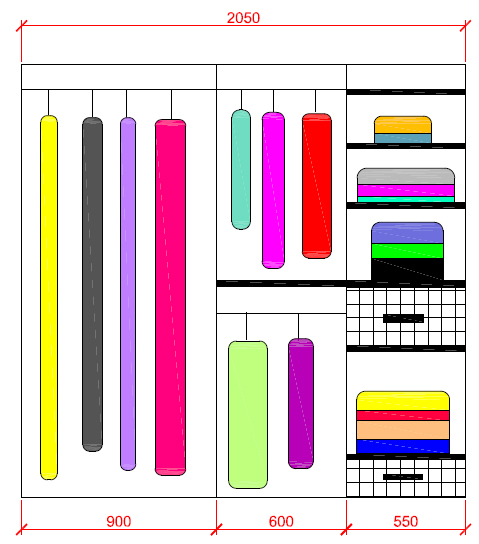

Lone71 Posted October 12, 2010 Author Posted October 12, 2010 Yes I see what you mean.... Ive worked on it some more, the middle section below is meant for shoes, but do not know how to deaw them..... There are now vertical dimensions.... Do not know how to center the handles either, yes Im new at this.... Quote
ReMark Posted October 12, 2010 Posted October 12, 2010 (edited) Are you familiar with Osnaps? Have you heard of the MTP (also known as the M2P) command? It locates the midpoint between two points. The rod you hang the clothes is still shown as a single line not a double line which would indicate it has a diameter. The vertical separations between sections still have no thickness. You might consider add a slanted show shelf in that middle-section instead of just an empty space. Edited October 12, 2010 by ReMark Quote
