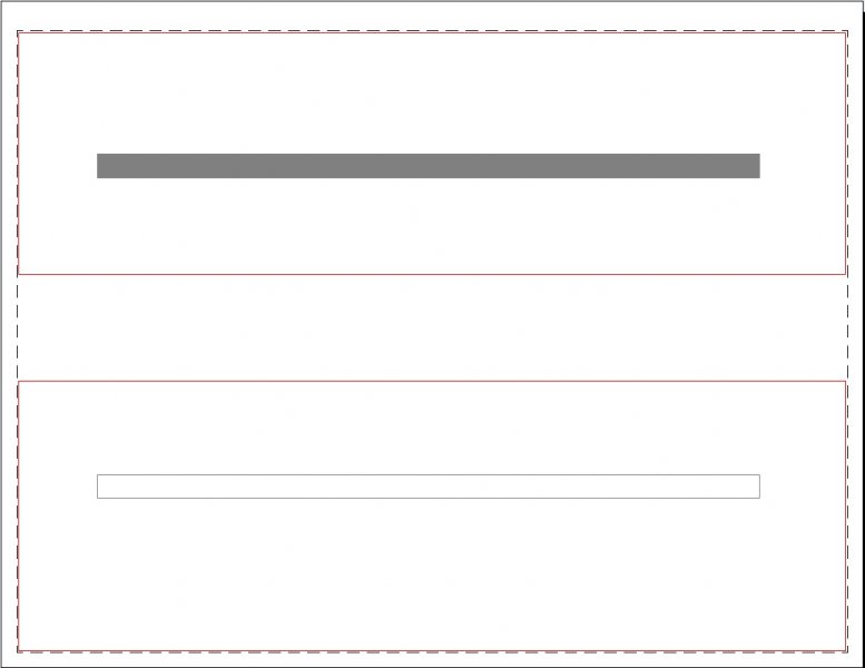

matatmicad Posted October 13, 2010 Posted October 13, 2010 Hey, can somebody remind me please what the variable for the display to change polyline with widths to rectangular kind of lines is? I know what I need just cant remember the command. Its a visual one so the polyline could look different in each port. ty. Quote
matatmicad Posted October 13, 2010 Author Posted October 13, 2010 nope not that command, thanks though. Quote
rkent Posted October 13, 2010 Posted October 13, 2010 shademode, 3dhidden will also do it. After FILL command you have to do a regen. Quote
JPlanera Posted October 13, 2010 Posted October 13, 2010 What is a "recangular kind of line"? If all you want to do is just show the outside of the "wide" line, then as rkent said, FILL then REGEN... Quote
matatmicad Posted October 13, 2010 Author Posted October 13, 2010 It isnt any particular visual setting but a specific polyline issue. Basically any polyline with a width +0 appears as a elongated rectangle, theres a variable that applies to specific views or spaces that I am after. Quote
JPlanera Posted October 13, 2010 Posted October 13, 2010 im sorry, im not sure i understand... in your first post you say it is a visual one, now you say it isnt any particular visual setting... are you refering to THICKNESS??? Quote
matatmicad Posted October 13, 2010 Author Posted October 13, 2010 apologies, it is a visual setting set to a specific view that changes the polyline iteslf, but not anything to do with ucs orientation, thickness, 3D settings. Basically in one viewport the polyline is a 50 width line, in another it is a stretched rectangle. Quote
matatmicad Posted October 13, 2010 Author Posted October 13, 2010 yes thats the issue we have and require the variable for. Quote
JPlanera Posted October 13, 2010 Posted October 13, 2010 Well this is infact a use of the FILL command.. Set up your viewports in the manner you require. Activate the viewport in which you want the stretch rectangle to be. Type FILL at the command line and set it to OFF. Then REGEN. This only changes the selected viewport, so the other one will still show the "width" of the line. Exit the viewport, and you're done! In the end, this is not a variable more or less viewport manipulation. If there is a variable out there, i dont know of it... Hope this helps. Quote
