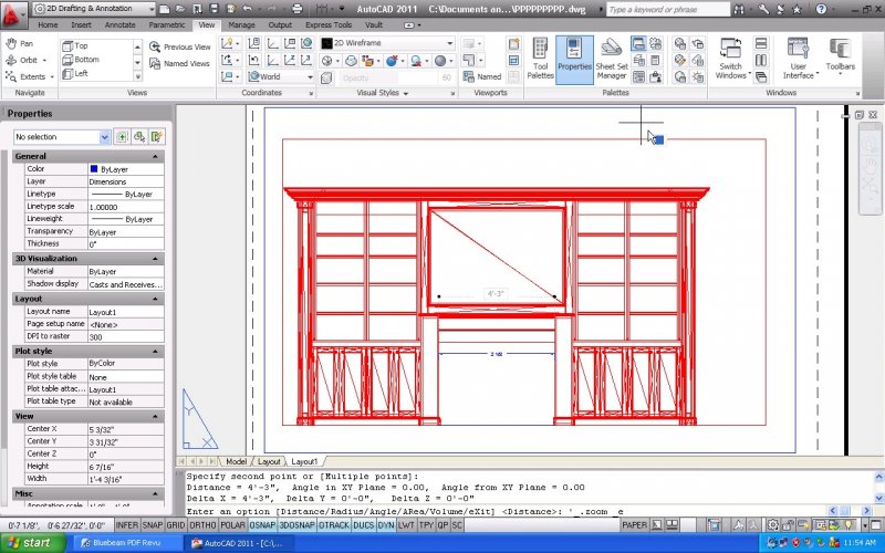

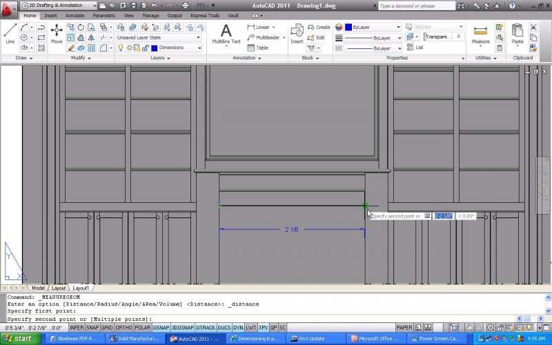

Dan911 Posted November 7, 2010 Posted November 7, 2010 I almost exclusively dimension in my layout (paper space) rather than deal with doing so in model space and have never had a dimension change (increase or decrease) on me. Is your dimensioning associative? Are the viewports locked? Can you post a representative drawing? I exclusively dimension in paper space also, but that's in 2D. I've been messing around in 3d and having a problem with dimensioning in paper space. I inserted 2 photos showing my problem. The first photo shows the incorrect dimension, but with the measuring tool it shows the correct measurement. The second phot shows the incorrect dimension, but before my second click with the measuring tool it shows the same incorrect measurement. My dimension associate is check in my prefrences, and you can see in photo's I am in paperspace. I would appreciate any help with this, this 3d stuff is really frustrating Quote

Dan911 Posted November 7, 2010 Posted November 7, 2010 No, I'm referring to the measuring tool that was found on the inquire toolbar in older versions (measuregeom)command. That's what I find so fustrating, the inquire tool is giving the correct measurement and my Linear dimension isn't. Quote
ReMark Posted November 7, 2010 Posted November 7, 2010 I use the Distance command to check dimensions. I can't think of a reason why the "inquiry tool" returns the correct dimension but the dimension itself is wrong. Quote

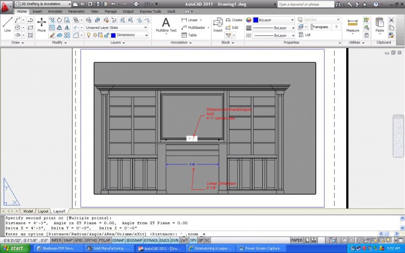

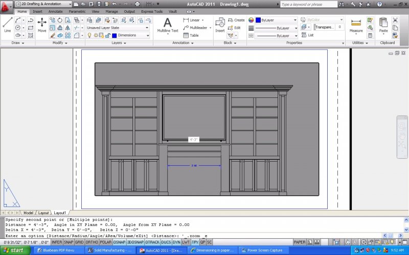

Dan911 Posted November 8, 2010 Posted November 8, 2010 Well if you can't think of a reason than I don't have a shot in figuring it out...lol It already cost me my Sunday trying to. I realized the images I uploaded my be hard to see, so I uploaded another that my be easier see and prove I'm not nuts. I really appreciate your interest in helping. Thanks again. Dan Quote

ReMark Posted November 9, 2010 Posted November 9, 2010 I fooled around with it for about 30 minutes and thought I figured it out when I got it to dimension 51" (4'-3") in the location the dimension showed as 2 1/8". Then I lost it on the next dim. Interesting problem though. I wanted to say it had something to do with the Overall Scale Factor as 51 divided by 2.125 = 24. 24 is the scale factor for 1/2"=1'-0". Did you draw the object "to scale" in model space? Quote
Dan911 Posted November 9, 2010 Posted November 9, 2010 Yes to scale, but not in model space, it was imported in from another program (Solid Manufacturing). I normally export as a 2d then clean it up in model space and dimension with my title block in paper space and never had a problem. "The cad in the program is weak and cannot compare to AutoCad" Lately I been messing with 3d and exported that file from SM as a 3d. I probably should of mentioned that it's a polyface mesh, not that means anything to me. Regardless... What I found so frustrating is the distance tool in AC gives the correct dimension but when I tried to dimension it it's incorrect. Thanks once again for your time and help, Dan Quote
ReMark Posted November 9, 2010 Posted November 9, 2010 Oh, so this was not done natively in AutoCAD. I see. Agreed. Distance command gives correct dimension but the dimension itself is 1/24th of what it should be so there is a scale factor setting we have to find and reset. Quote
