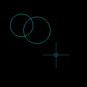

David I may be wrong, but I believe Aleksa is referring to the translucent shading when windowing over objects:
Exaggerated example:

Lee, you understood me perfectly. David sorry if I wasn't clear on what I was trying to achieve, but english isn't my native language, so I didn't think of such an obvious way to explain it, as translucent shading is. You've resolved a dilemma for me in any case.
