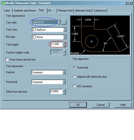

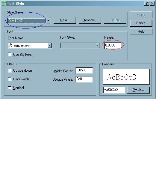

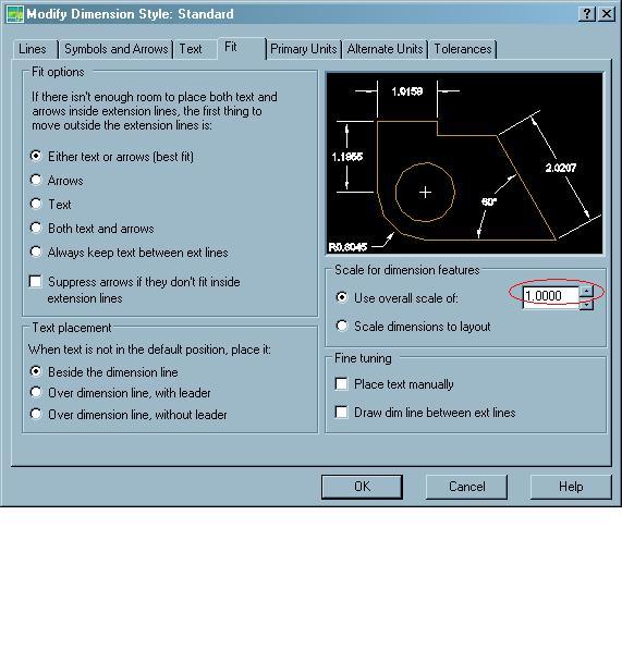

smorales02 Posted September 16, 2008 Share Posted September 16, 2008 instead of setting your "over scale" to your VP scale just set it to 1 and your text height to whatever size you want it to be in paperspace. than in your text style manager select your text that you are using with your dims and make sure that the height is set to zero.. if your still getting confused I will post some screenshots Quote Link to comment Share on other sites More sharing options...
smorales02 Posted September 16, 2008 Share Posted September 16, 2008 Set the red area to 1 Set the Red area to what you want your text size to be in paperspace and make note of the text style you are using (blue circle) Select same text style as previous image and set the red area to 0 Your text height should now be the correct size when you dimension Quote Link to comment Share on other sites More sharing options...

Rockford Posted September 19, 2008 Share Posted September 19, 2008 Once you setup a Dim Style to any scale, its easy to duplicate that Style for other scales ie 1/2", 1/4",1/8" =1'-0" and so on. All you have to do is go to Dimension Style editor select New and in the Create New Dimension Box Select the Style you want to start with (the one you just setup), give the New Dim Style a name Click Continue then in the next box 'New Dimension Style' at the Fit Tab (shown above) just enter the Scale Factor in the Scale For Dimension Features and check the Use overall scale of box. Above it is shown as 1.0000 so for a 1/4" scale it would be 48.000 for 1/2" 24.0000 and so on. Then your text arrow sizes etc will all be 'scaled' to your drawing. You can also right click on any toolbar then click (check) on Dimension to show the Dim Tool Bar, dock it on your screen and then easily change between Dim Styles Note: Morales02 reply above shows the "Modify" box make sure you click "New", not Modify, in the Dimension Style Editor box to creat another "New" Dim Style. Quote Link to comment Share on other sites More sharing options...
