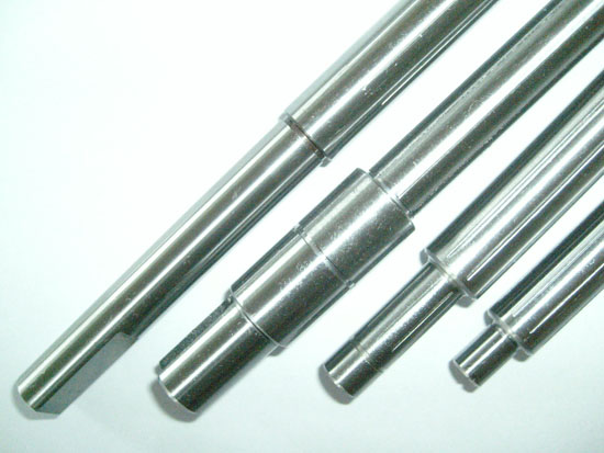

I sometimes have to create rough machine profiles, and they are all stepped shafts with dozens of different diameters. So to make drawing them easier, i created this lisp to draw one "side" of the shaft when diameters and step lengths are known.
I have this thing in an infinite loop right now. What is the correct procedure to end the loop with an Esc or Enter?
I'm guessing you are drawing elevations of similar shafts as in pic?

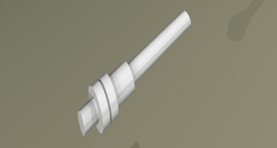

I had to add a 3D option. It's just me
[b][color=BLACK]([/color][/b]defun c:ssel2 [b][color=FUCHSIA]([/color][/b]/ sp d l n sc i sl od np xp p1 p2 tmp input[b][color=FUCHSIA])[/color][/b]
