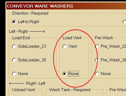

David Bethel Posted October 26, 2010 Share Posted October 26, 2010 I do it a bit differently but there should only be 1 active choice in that scenario. : boxed_column { label = "Load Vent"; : radio_column { : radio_button {key = "LR-VENT"; label = "Vent"; } : radio_button {key = "LR-LOAD"; label = "None"; } } ???? -David Quote Link to comment Share on other sites More sharing options...

David Bethel Posted October 26, 2010 Share Posted October 26, 2010 Formatted properly, a radio_column only allows 1 selection. -David http://www.jefferypsanders.com/autolisp_DCL_Part5.html Quote Link to comment Share on other sites More sharing options...

Lee Mac Posted October 26, 2010 Share Posted October 26, 2010 Why not use a row of two columns? : boxed_column { : row { : radio_column { : radio_button { } : radio_button { } } : column { : image { } : image { } } } } Quote Link to comment Share on other sites More sharing options...
